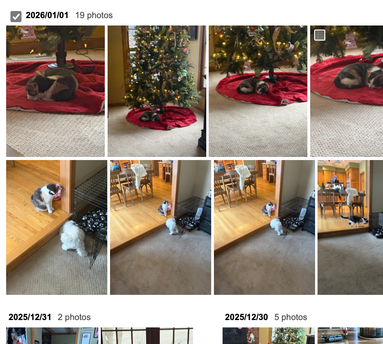

So QuMagie takes your photos and sorts them in the interface by date.

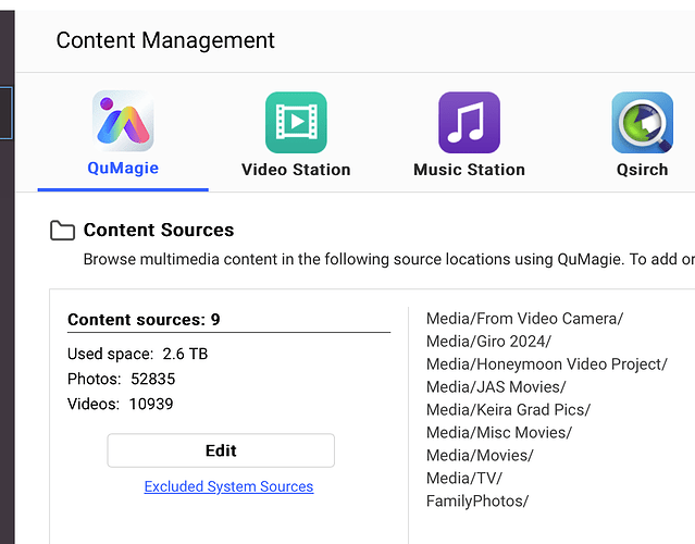

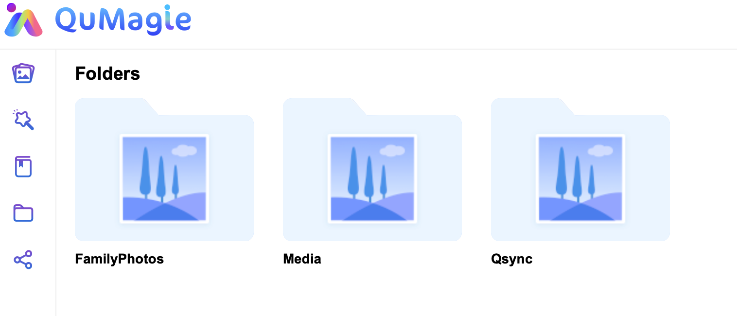

Folders are set up/configured as folders containing image data in Multimedia Console:
Albums is maybe what you would be looking to use. There seems to be a good bit of flexibility with them.
Thanks for the extra effort to assist. I wasn’t quite sure how QuMagie prefers photo image folders because the dates of the photos can be unclear. For example, sometimes photos have EXIF data and at others they don’t. Same goes for correct create dates, which you have to hope is embedded into the file name if all the others are absent. I recall that QuMagie can also use date based hierarchies, e.g.

I’ve seen issues with QuMagie getting old pics assigned with new dates. I’m not sure what it was about these handful of photos (bad EXIF data so it used the date when the file was copied over to the NAS?). But everything else I have going back over 20 years is great.
