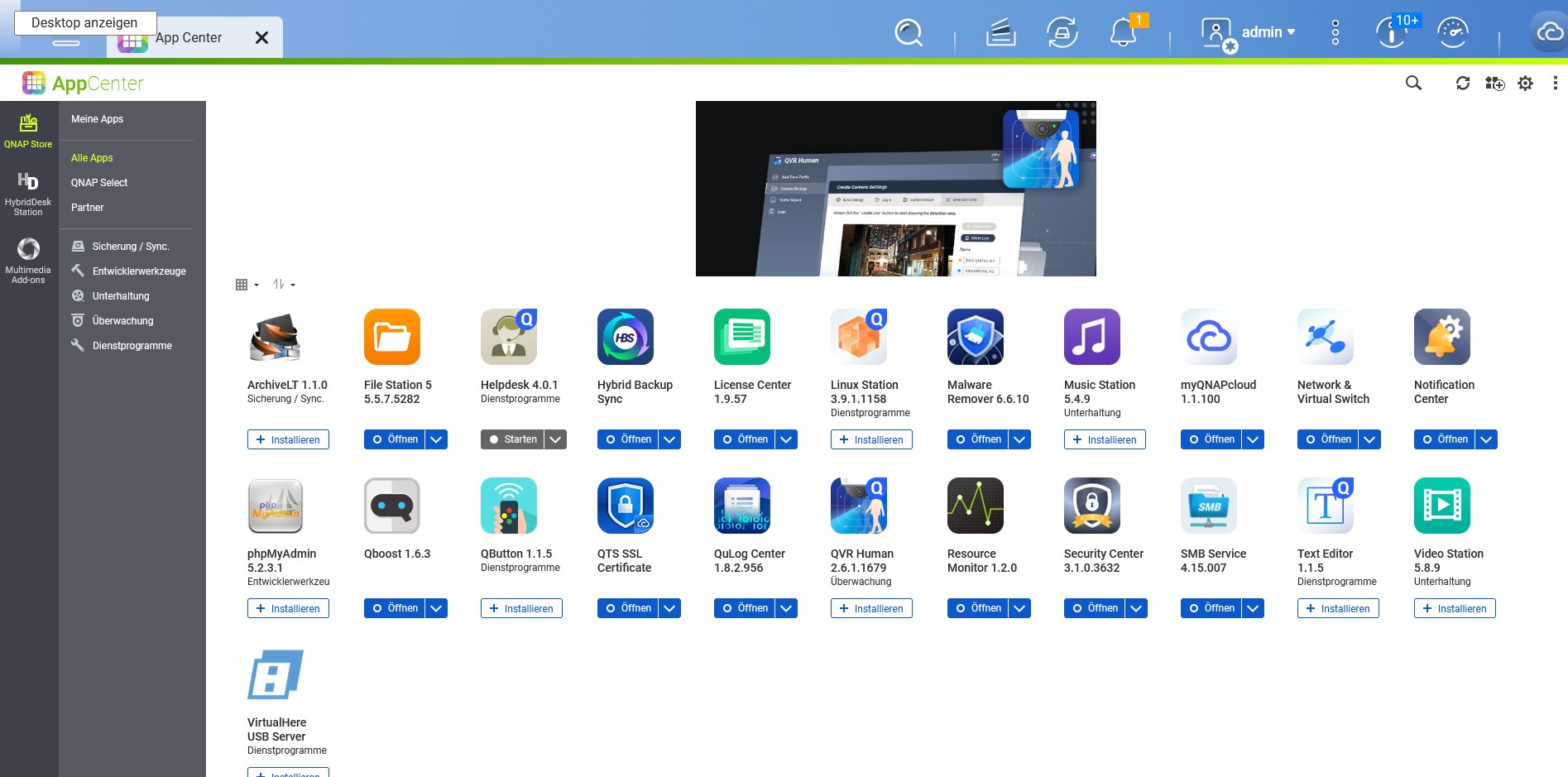

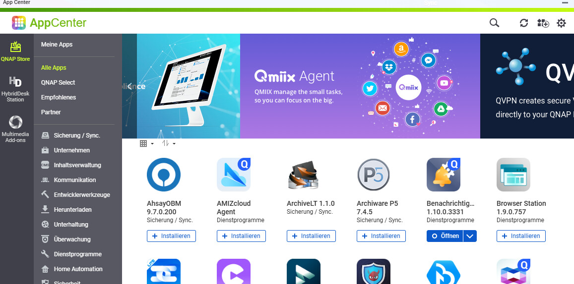

What does your screen look like for all apps?

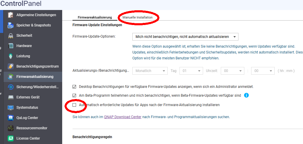

If that doesn’t work, I would manually reinstall the current QTS version and activate automatic app installation.

All apps look like this:

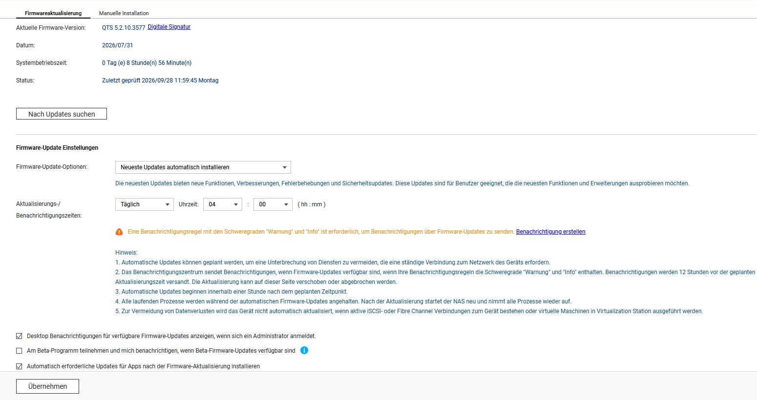

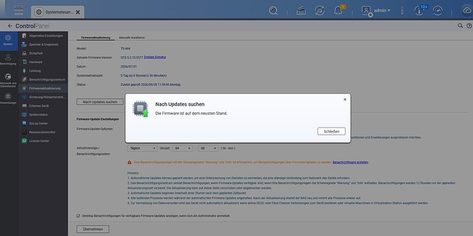

QTS is already up to date:

You need to download the firmware onto your PC and then reinstall it manually.

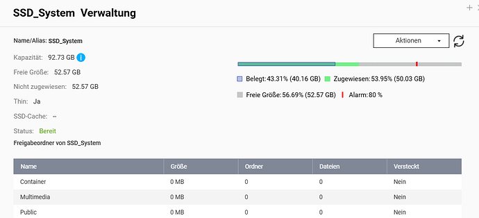

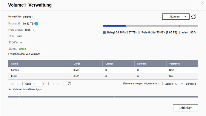

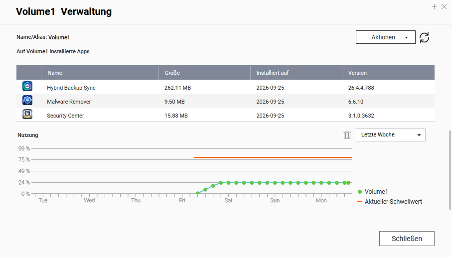

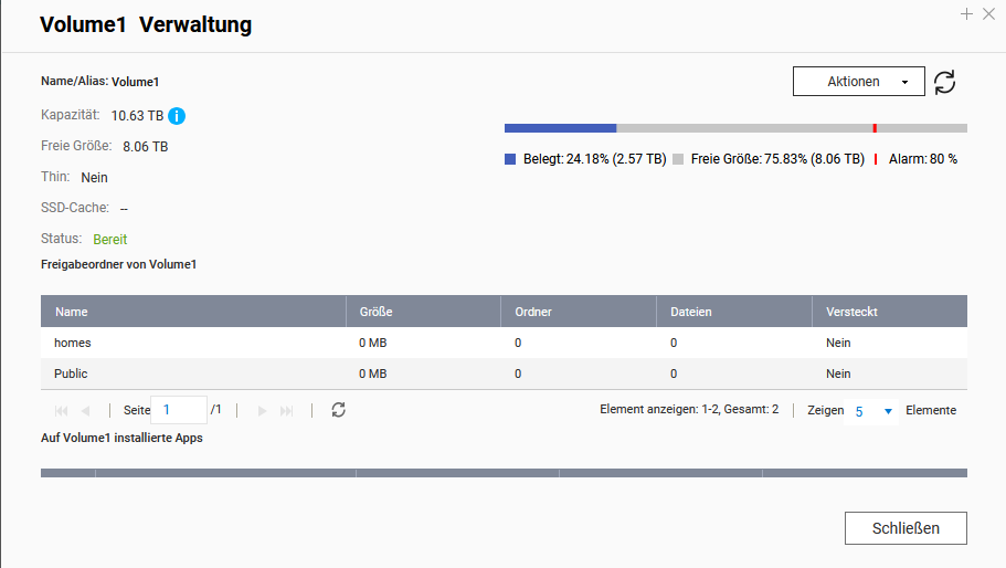

What does your system volume look like?
I downloaded and installed the firmware manually — no change.

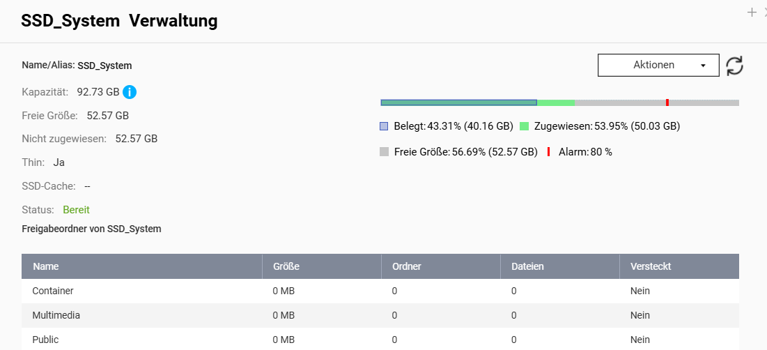

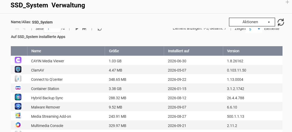

Attached are screenshots of the volume:
You’re using a static volume?
I only see two folders in your shares.

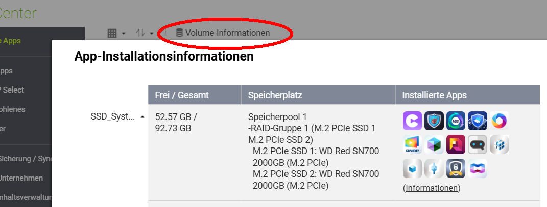

What does the volume info show in the App Center?
This will probably end up being a ticket for support.
Yeah, actually I just need the “public” one.
