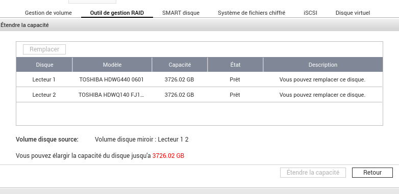

Some pics :

Also make sure you switch your UI from French to English before posting screenshots

Etendre la capacité” in French means “Expand capacity
