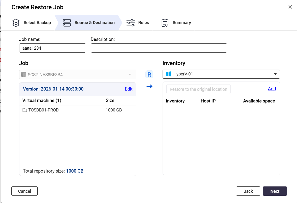

Critical need help: TS-673A, HDP2.3, Agent 1.3.1 on VM cannot restore after select source the right hand side is not list destination folder
I’m using TS-673A, FW: 5.28, HDP 2.3.2 and Agen 1.3.1 one VM is not able to restore. After pick VM from backup to restore on the Left side then the right side is not list destination folder so it is not allow to move next step. Tried to change destination server result are same
my environment is Hyper-V cluster 2019, 2 nodes

You can try clicking “Add” in the right sidebar. Does this help with the issue? Thank you!
