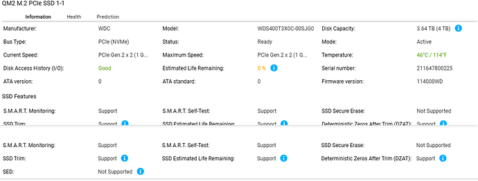

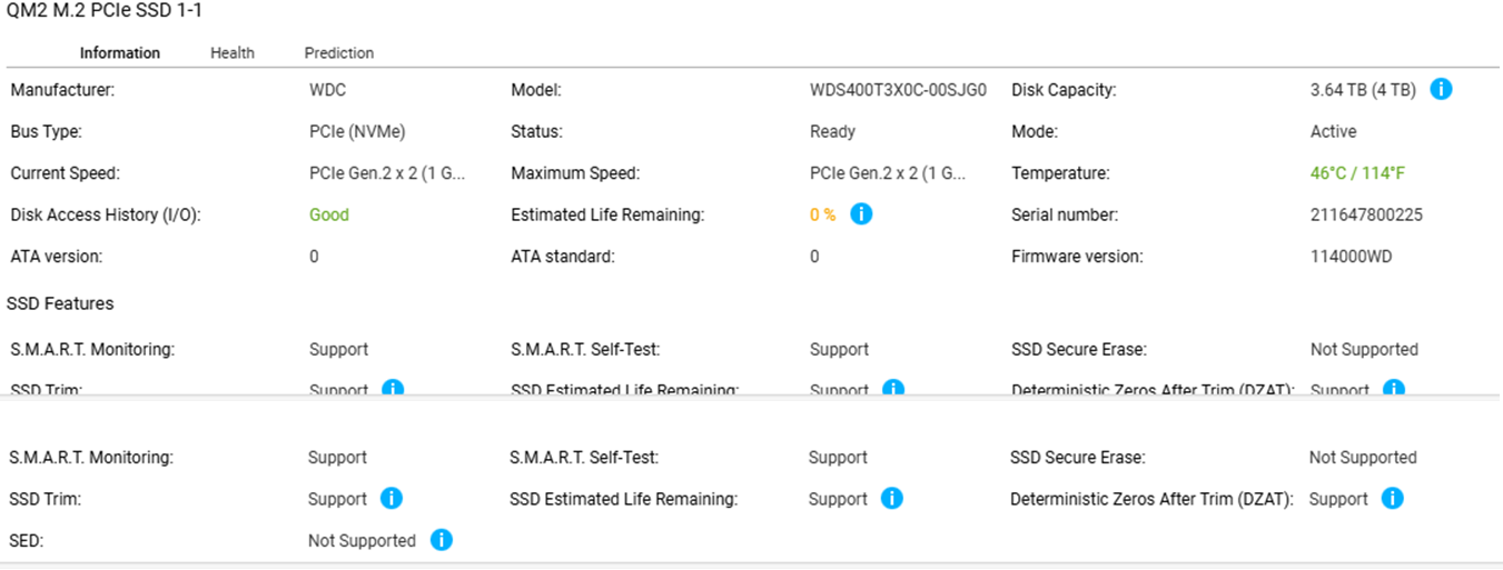

this is all i received.
That is the overview of a disk (with 0 lifetime remaining, but no problem…yet)
I am talking about the overview (the look can be different depending on OS and OS version used.. both not known)

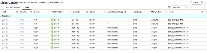

Here a demo of what it looks like in a TS-853BU running 5.2.7.3297
6xData and 2xQtier SSD (showing all up as ‘data’), disabled cache should show up as ‘free’
