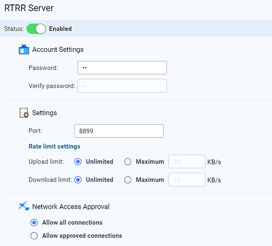

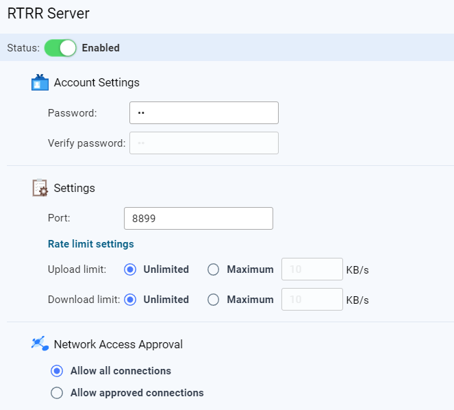

RTRR server is enabled on both NAS and remote mount works both ways. RTRR network access approval is set on both to “Allow all connections” Administrator has full read/write permission on all folders involved.

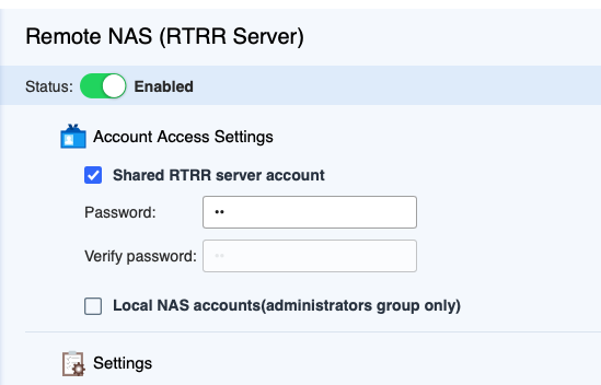

There are a couple of ways to access the NAS through RTRR. One is to have a unique password just for that or use your local admin accounts:
Are you using the Shared RTRR server account or the Local NAS account? When you set up the job on the other side, it should attempt to authenticate. Is there where it is failing?
Thanks Jon.
I’m using a shared RTRR account on both machines. Same password. The RTRR server settings on the older 879 box does not have an option to use Local NAS accounts.

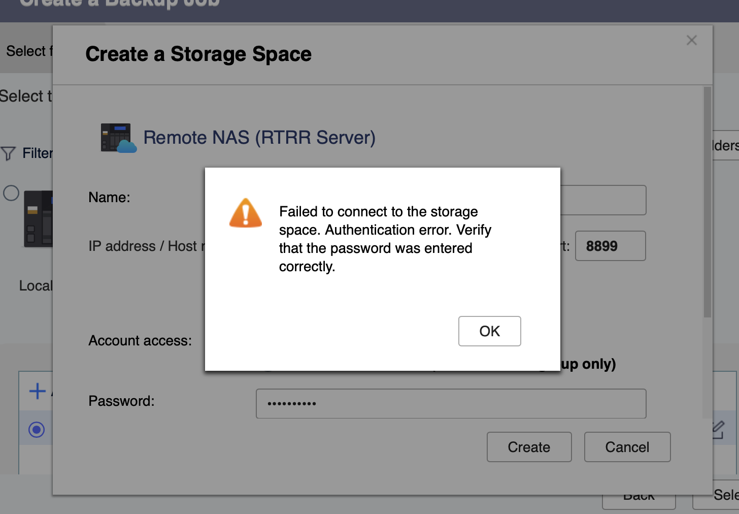

Starting a backup job from scratch give the same result. Permission denied.

Is this where you get the error when trying to set up the job?
Or are you getting it when the job is actually running.
I am wondering if there was maybe a username change between the older NAS and the newer one. I would open a support ticket with QNAP if I were you.
When the job is running - or trying to run. Backup job starts and then 10s later I get the error. NASes can see each other via RTRR and can mount each other’s folders in File Station. Baffled.
A ticket with QNAP is a good idea.
Yeah, I would open a ticket because if you can set things up for the backup (authentication is tested there), then it should work when you run it.
