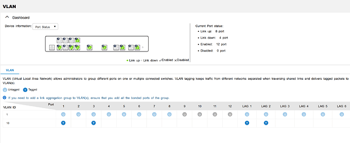

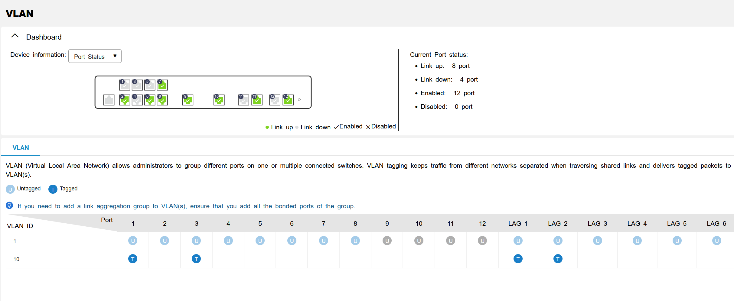

go into the vlan section and make sure it tagged on the port that needs it.
Also you only need to setup that if you are using vlans on your network. Vlans setup is not needed just to connect the two switches together.
PS i have a few other switch brands and some call it trunking (might be level 3 switch feature idk vs just setting up vlan and allow that tagged traffic through.)
