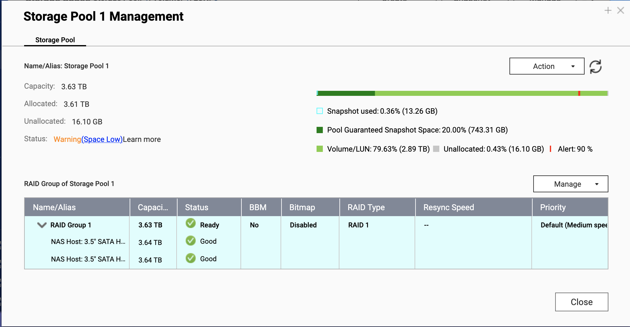

I’m new at this and I planned poorly. See attached and you see I installed (2) 4T drives and I’m at a 90% threshold warning. I still have more to sync. Using the adage from an old, Woody Allen movie, “these things always travel in pairs”.
I’ll need to up-size, probably to 2 each 8T hard drives. Is there a programmed way to do this? Or do I need go back to the source files I originally sync’d while setting up.
Also, assuming there is a “system” to move the existing data to a larger drive. Is there a beginners document for formatting the new drives? I did something very wrong the first time. I created a ridiculously small storage pool to start (about 380G), so I filled this thing up in 10 minutes and had to post to the forum which figured it out for me.

I would also suggest lowering your pool guaranteed snapshot space. Right now it’s allocated to 20% of your drive space. You likely don’t need that much space for snapshots.
