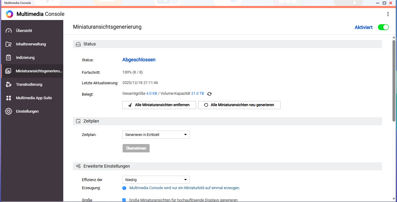

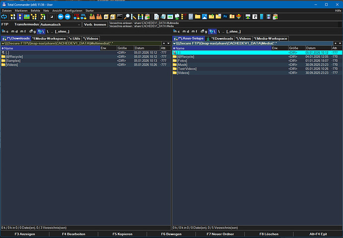

To demonstrate my problem, I reinstalled Media Console and Media Streaming add-on on my TS-464.

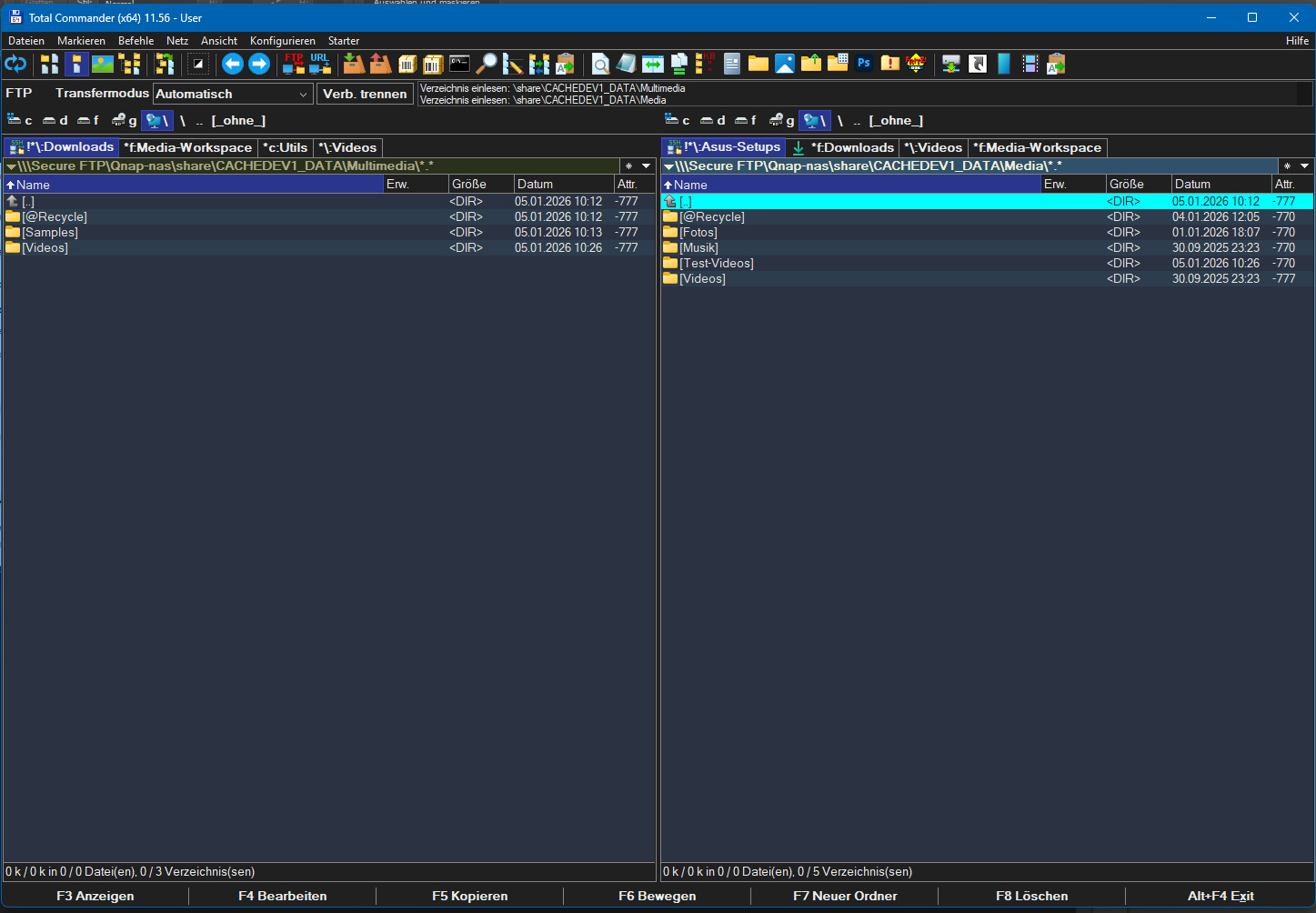

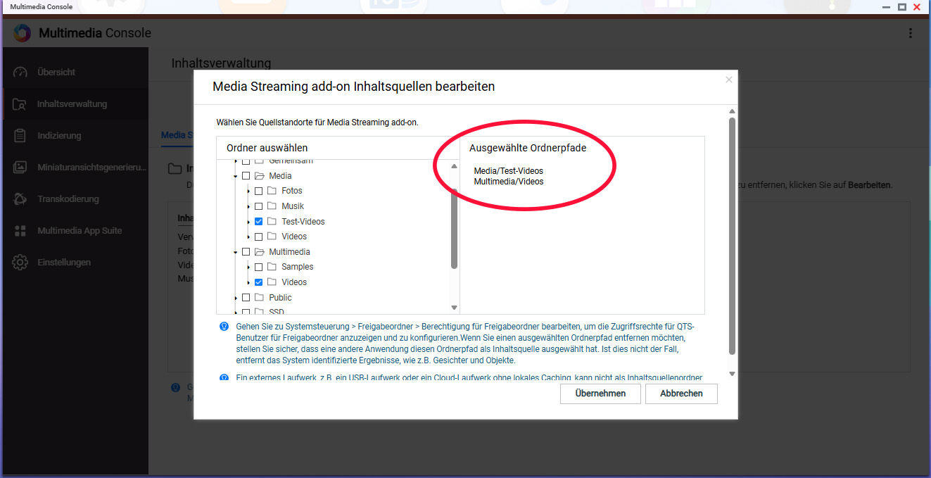

My media files are located in the shared folder “Media”. For testing purposes, I created the folder “Media/Test-Videos”. In the “Multimedia” folder, I created the folder “Videos”. Each of these folders contains 4 video files. Then I added these folders in “Multimedia Streaming Add-on –> Content Management”:
After indexing, it looks like this:

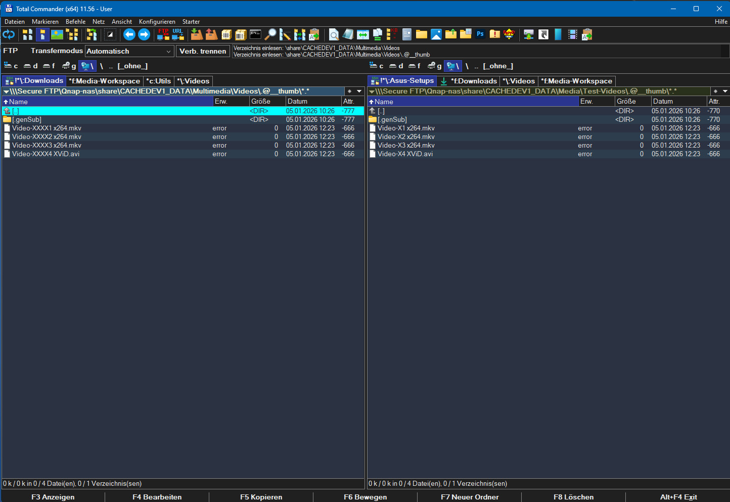

Here you can see that the folders “.@__thumb” were created in both Media and Multimedia. THIS TRIGGERS PLEX!!!:

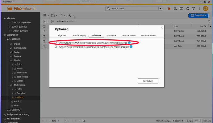

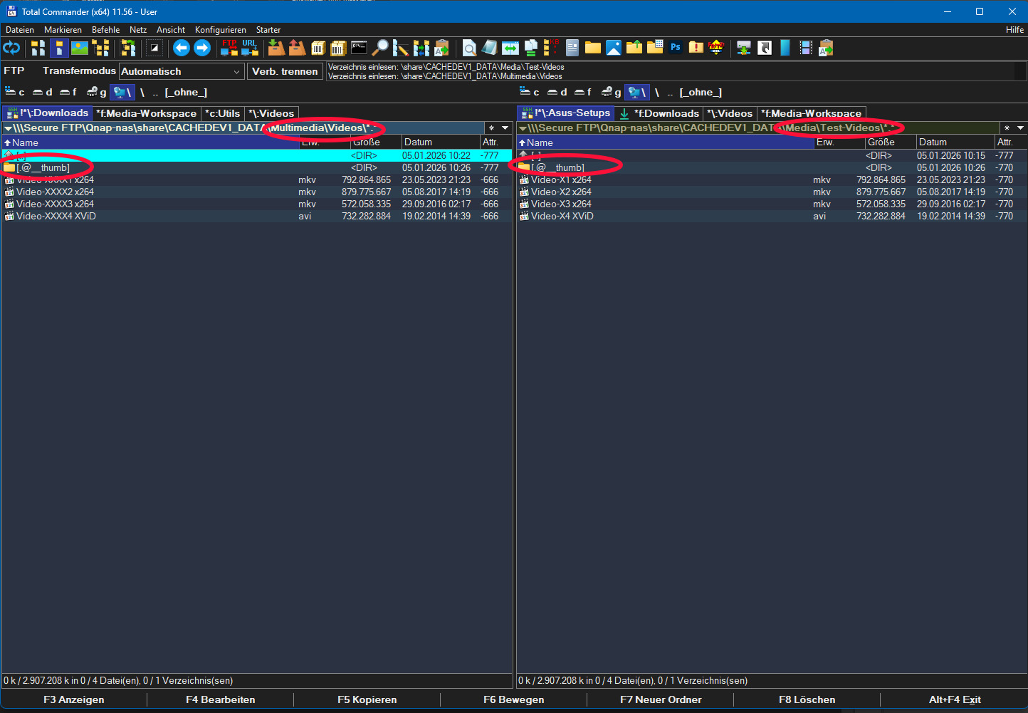

Now, if I check Multimedia in File Station

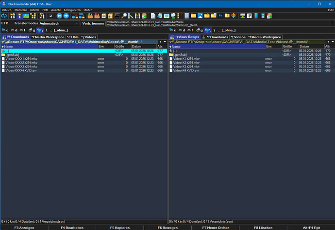

and then scan the directories with File Station, files are created in the “.@__thumb” folders. EVERY WRITE ACCESS TO ONE OF THESE FILES TRIGGERS PLEX!!!:
As you can see, the folder “.@__thumb” is created everywhere there are media files.
If QNAP were to create these folders outside of media folders, a Notify for the media folders could be generated only when a media file is changed or added.
