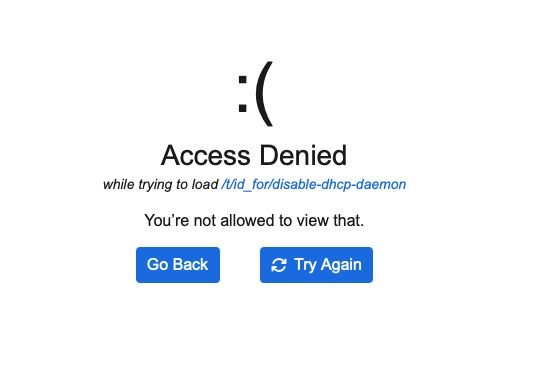

Maybe but when I go to that link I get this:
fixed my link above
Aha! That’s right. It was DHCPd not NTPd. My bad…
