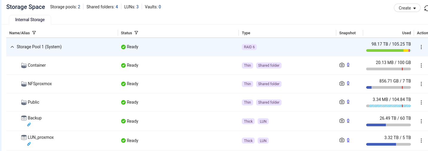

Sure, we have a TS-HX77AXU-RP, with 8 discs forming part of a pool, in this pool there are two iscsi LUNs one for backups and another one for a proxomox test environment
We are doing a backup to an external media and it’s hurting the performance of the proxmox LUN to a point that’s unusable

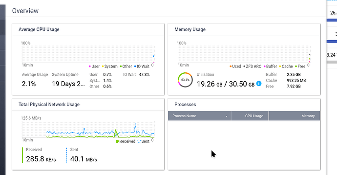

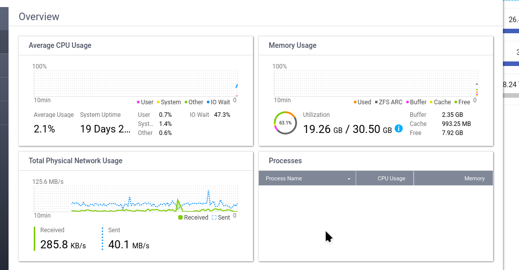

If I look to the resource monitor everyhing seems to be going great (and it’s not)

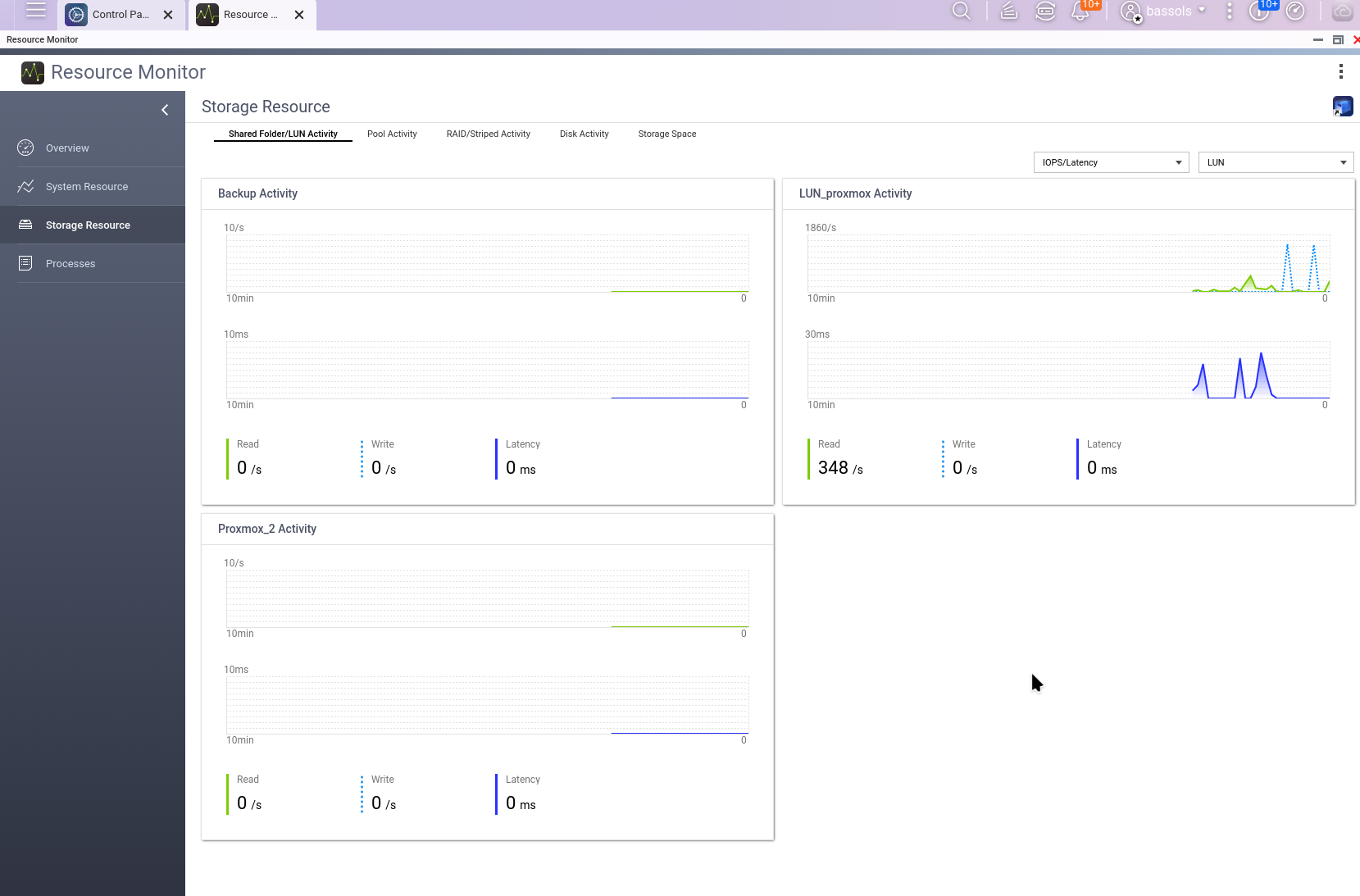

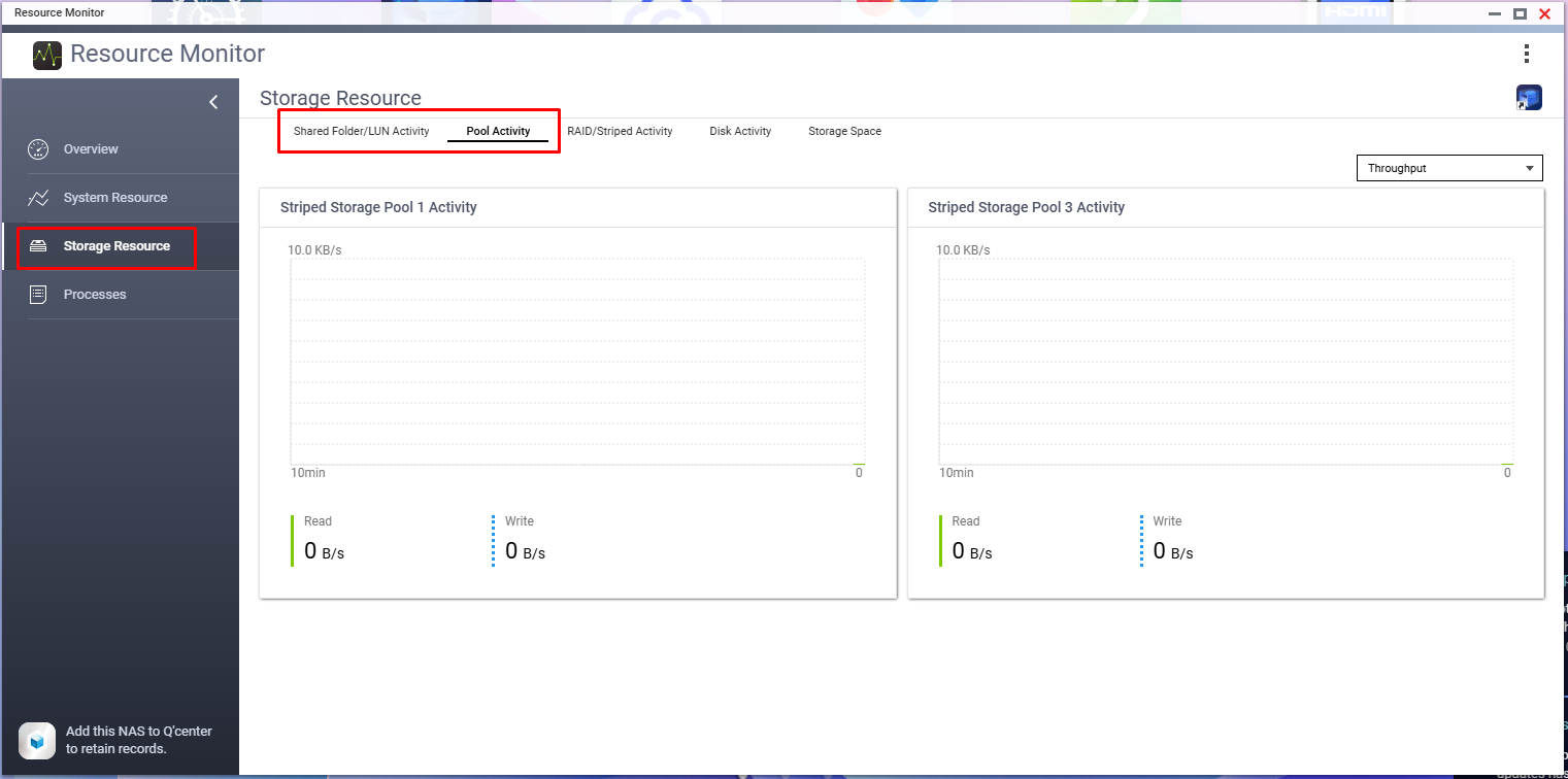

Could you share a screenshot of the Resource Monitor performance page?
Hi today the task finished so the metrics are near zero (we moved part of the load to nfsv2), but these metrics you show seem to be interesting to have montitored. Are they exposed via SNMP?
Currently, these performance metrics aren’t available via SNMP on QuTS hero. The existing SNMP performance OIDs were designed for the QTS volume structure and don’t cover the ZFS-based architecture of QuTS hero. I’ve passed this along to our internal team, and we’ll look into improving this in the future. Thanks!
