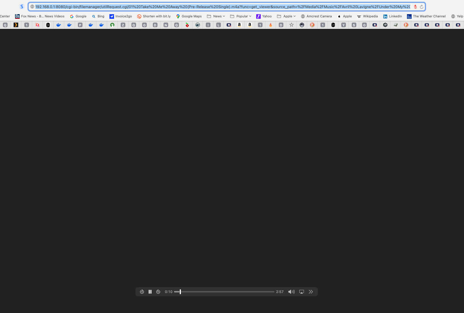

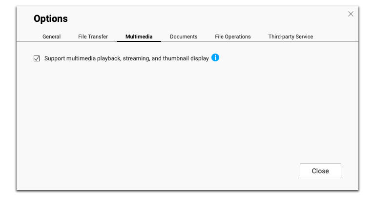

Probably the easiest way to do this is to have your bandmates get QNAP IDs. And create user accounts for them on your NAS. They can then log into the NAS and get the web interface via the myqnapcloud.com portal. Then they can go into File Station and play the files.

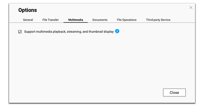

In order to play media files in File Station, click the three dots in the upper right of the file station window and select settings. Go to the Multimedia tab and check the box to support multimedia playback.
Now, when trying to play media on the QNAP, it will use the built in MediaPlayer. For some formats you may need to get a license for Cayin MediaSign Player and/or Cayin Media Player. That’s kind of a mess right now but until QNAP sorts that out, that’s what you need to do…
Now MediaPlayer takes a little bit of time and resources to load. If you uncheck the multimedia box above, I believe it should fall back to the native player in the browser. I am verifying that now…
Yep…

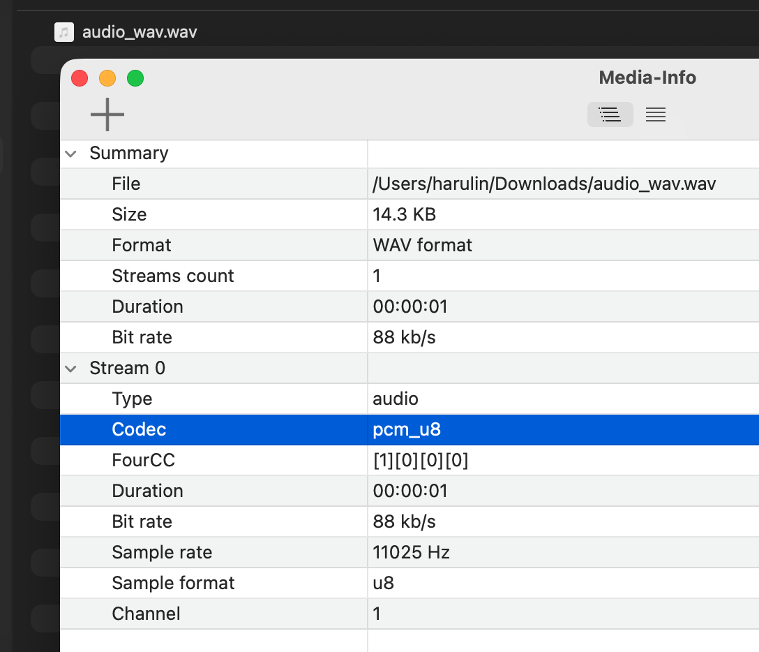

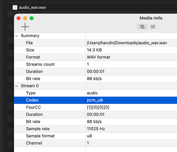

Unlike MP3, WAV is a container format and it can carry different kinds of audio codecs. If the WAV file contains an unsupported codec, it may not be playable directly.
You can share a sample WAV file or a short clip with us to verify it, or check what codec is inside the WAV file using MediaInfo application.
If you have FFmpeg installed, you can also confirm it with ffprobe :
ffprobe -hide_banner -show_streams -show_format your.wav
