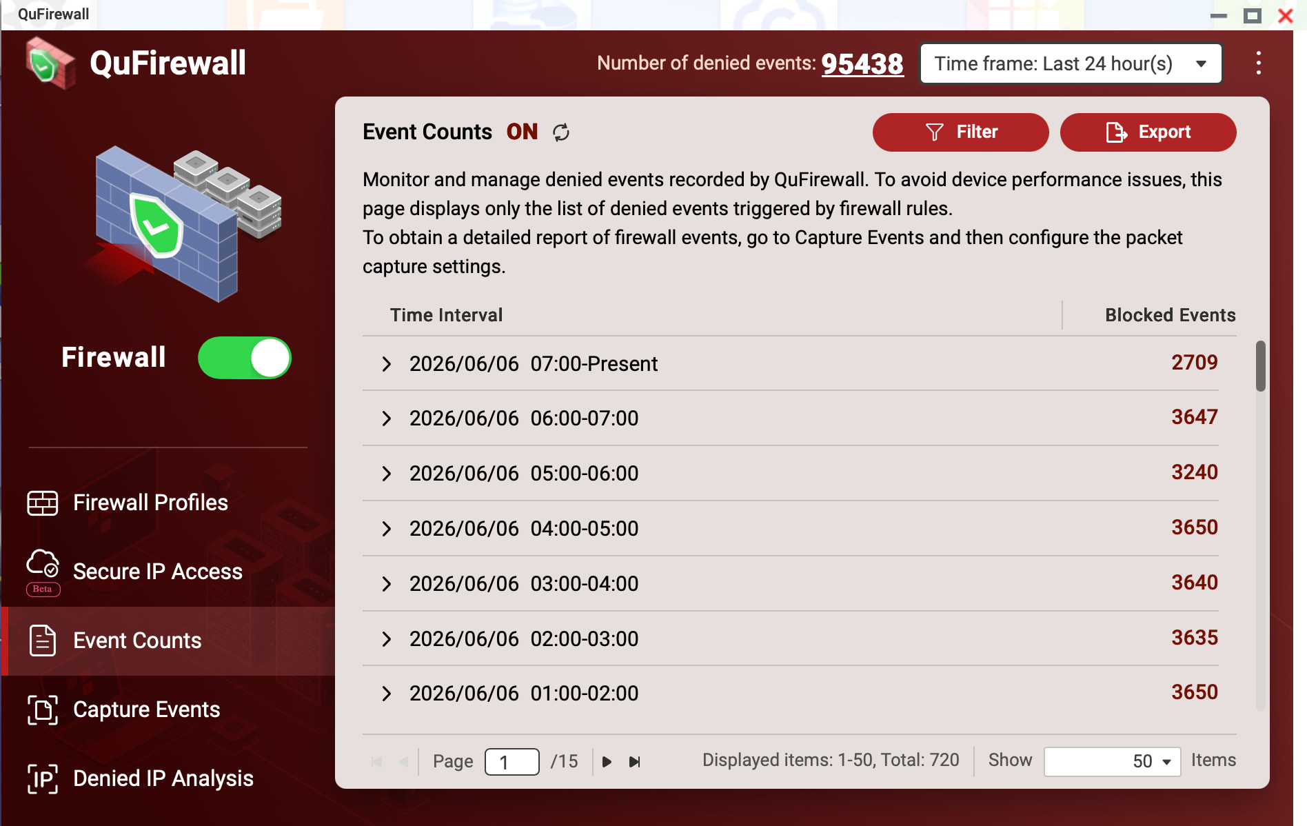

My TS-233 is frequently sending alerts for QuFirewall when it reaches 5000 events. Can I block or suppress connections from port 1900 so I don’t get so many alerts?

I’ve set the threshold for 5,000 so I don’t get too many notifications but still happens too frequently. I don’t want to set too much higher as that would defeat the reason for using QuFirewall.
Here is a link to the first three log files: Log files
Port 1900 is used to discover specific services or servers/devices on the home network. If these requests are coming from your iPhones, I would try to determine which app(s) are responsible. The QuFirewall logs shows multiple requests to port 1900 per second per iPhone! This indicates a faulty configuration of one or more apps on the iPhone.

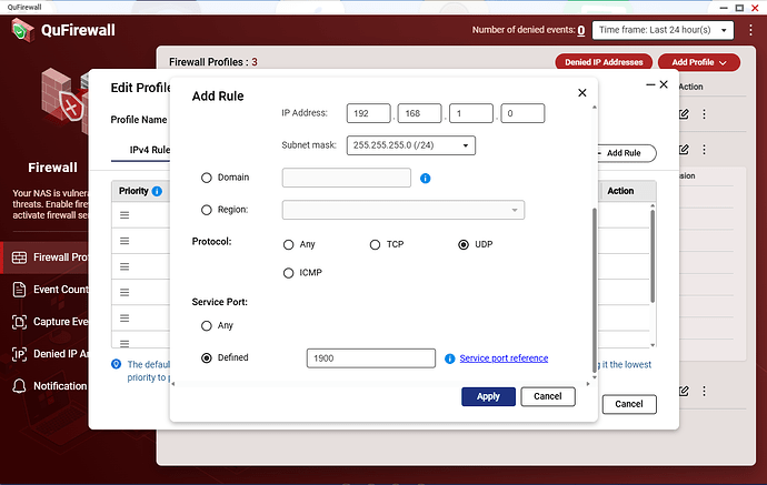

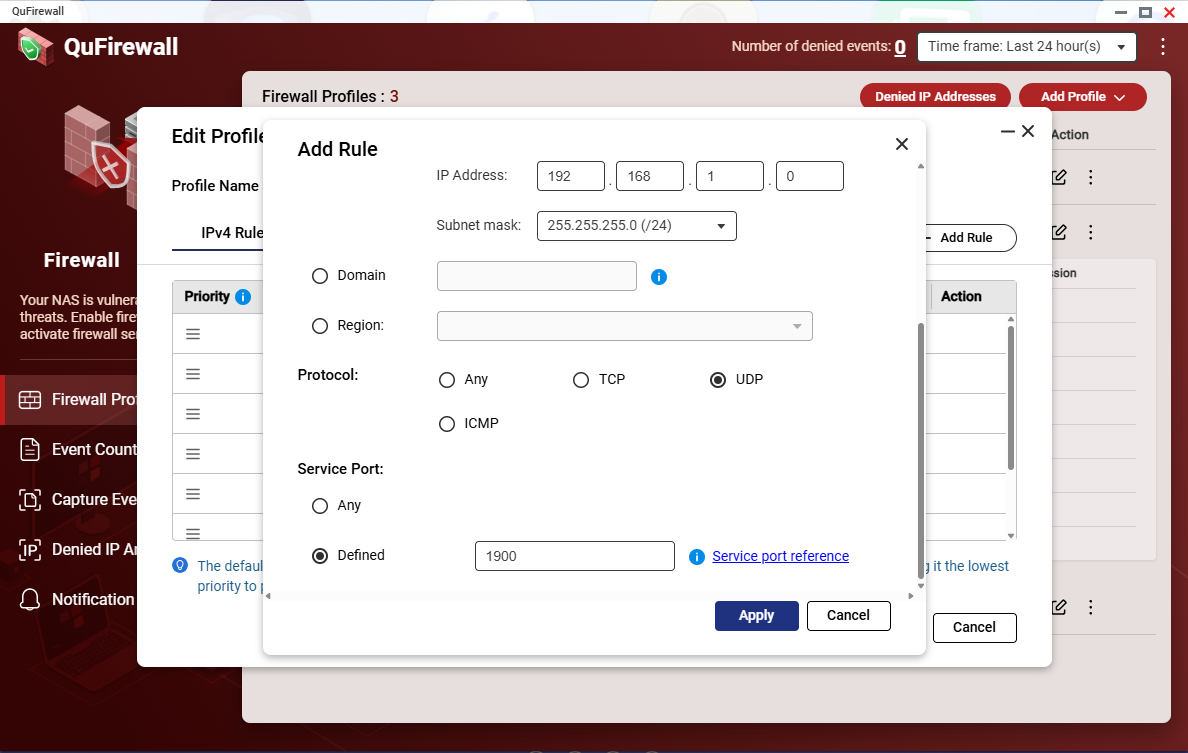

If your NAS is behind a router (not directly exposed to the internet) and UPnP is already disabled on your router, the risk of this traffic is very low. You can safely add a whitelist rule in QuFirewall to stop these events from triggering notifications:
  1. QuFirewall → Firewall Profiles → Add Rule
  2. IP: your LAN subnet (e.g. 192.168.1.0 / 255.255.255.0)
  3. Protocol: UDP / Port: 1900
  4. Action: Allow
This keeps your event counter clean without affecting security.
