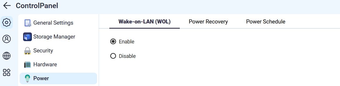

Just out of curiosity, I looked for this EU sleep mode - I don’t see it in the power settings for QuTS Hero. Maybe its just for QTS, or maybe my hardware doesn’t support it. Its a TS-h1887XU-RP, so it probably doesn’t support it since its a rack-mount unit.
“Control Panel”, “power” , “Eup mode” in both QTS and QuTS.
Guess my device doesn’t support it - I don’t have that tab available.
Probably means your device always uses less than 1 watt in power down mode.

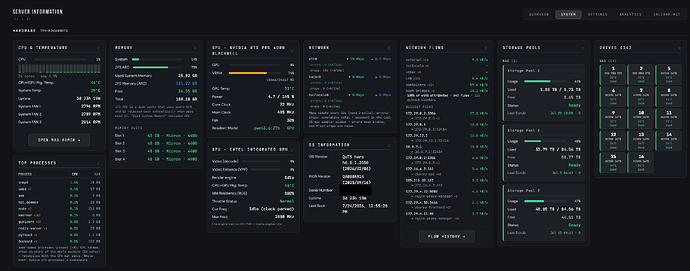

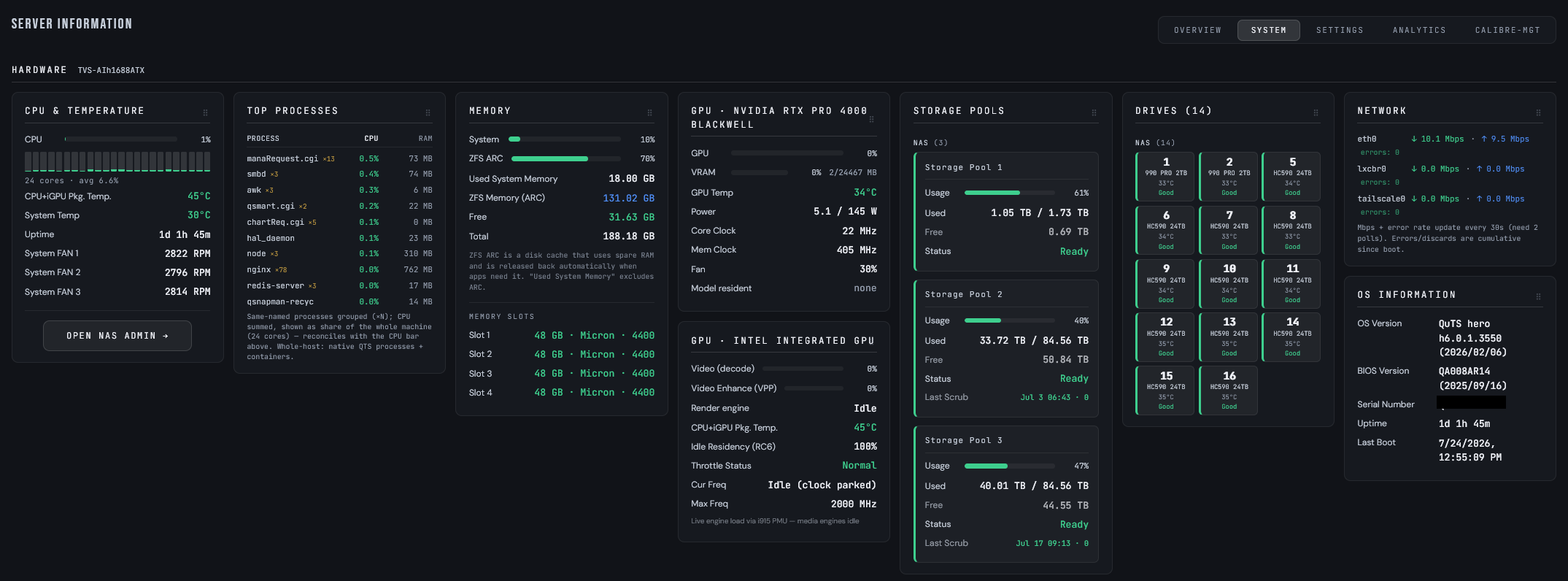

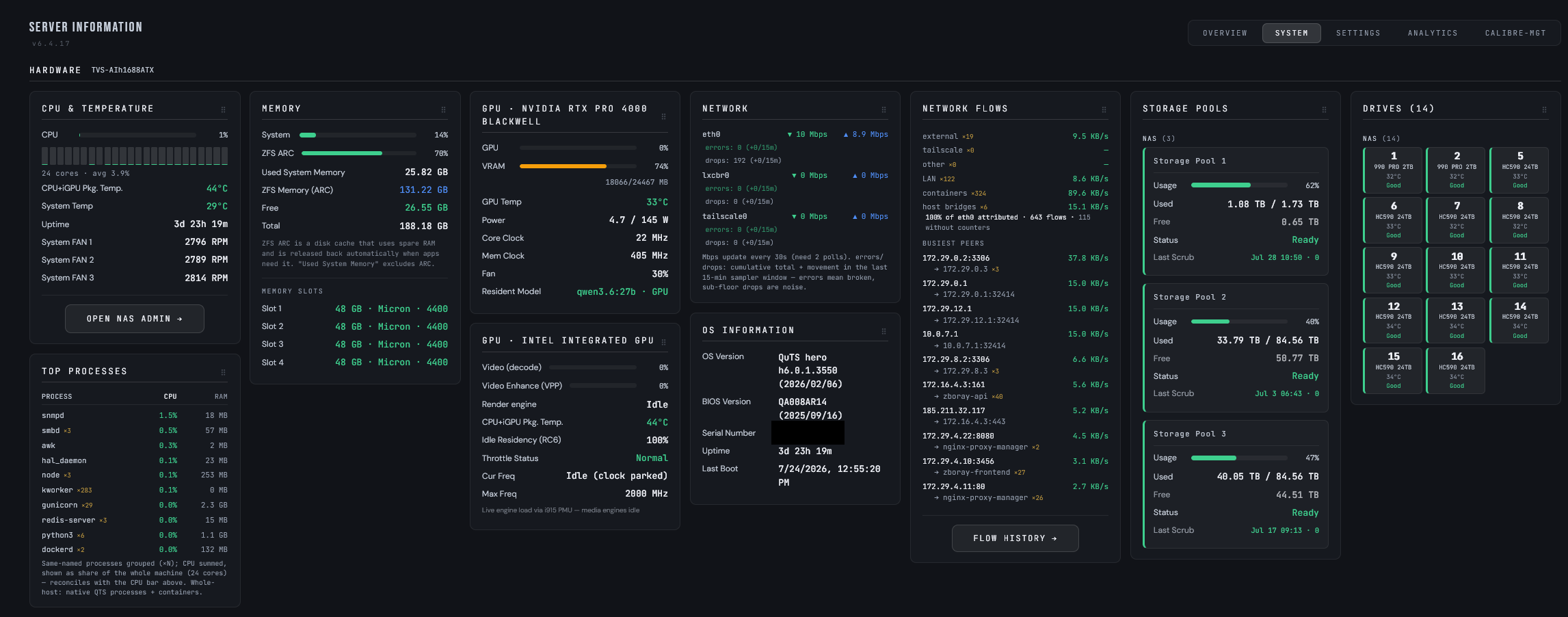

The dashboard I use to monitor the server is my own design. It also monitors all the containers and services as well as allowing me to manage them; start/stop/status/ignore (special use case). I don’t use container station. I build all my own Docker Compose files and bring the containers up that way.
The snapshot below has all the widgets loaded. What you can’t see is all the error reporting built into it. I’ve had memory problems with the NAS since I bought it (MCE faults) that have finally been isolated to the motherboard memory controller. It’s going in for repair tomorrow. Because of constant spontaneous reboots caused by this issue, I had to develop a way to see at a glance what was happening on the NAS. That’s how the dashboard came about, but now I use it daily to monitor the NAS and quickly isolate issues with containers, network issues, etc.
The other thing I’ve learned is that the NIC drivers for the atlantic chip used on the TVS-AIH1688ATX were handed off from alantic to Marvell and the original gitHub repo was abandoned. I don’t know who’s maintaining the drivers now, but there are issues I’ve run into that have caused at least 2 spontaneous reboots not related to the memory issues.
Rule of thumb: Don’t change NIC driver settings while anything important is happening. There has been a 50/50 chance of causing a reboot for me. Ring-resize changes will do it every time. I’ve also tracked the NIC dropping packets. If you look closely under Network, you can see my tracker at 192 dropped packets. That’s my current baseline; if it starts growing, I know my network connection needs to be bounced. Keeping the MB cooler seems to help. I’ve got my case fans running at 55% and the CPU at 50% at all times.
