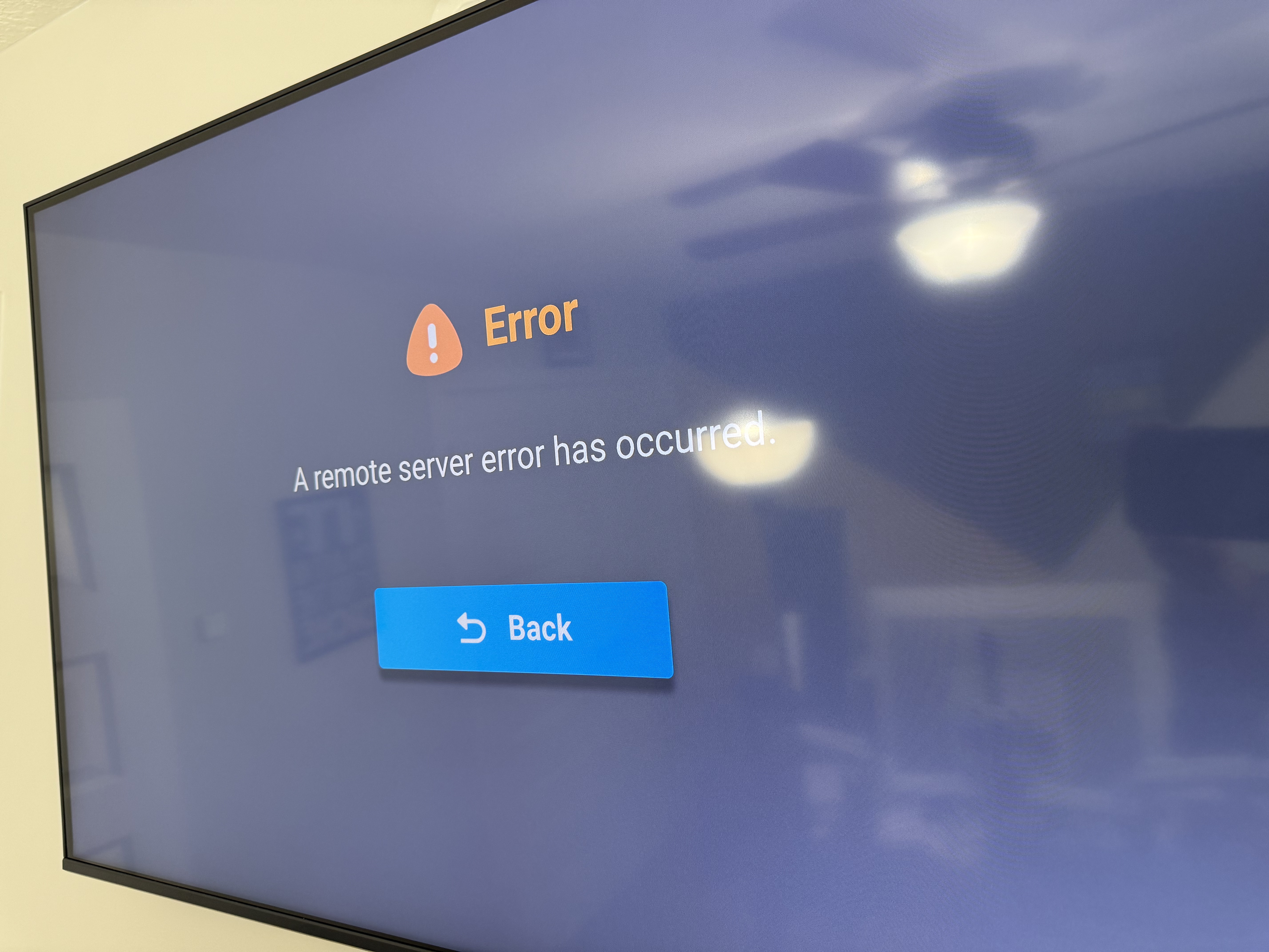

I have a ticket open for this (Q-202512-61740) but I wanted to bring awareness to the fact that the QVR Surveillance update (from QVR Elite on my TVS-h1288X in my case) results in a situation where the QVR Viewer app for Apple TV can no longer connect. This is a pretty big deal for us, as it was one of the selling points of the ecosystem that we could use any TV in the house to view our cameras. We have dedicated user accounts for the apple tvs with custom views etc. When you attempt to log in with QVR Viewer, you get the error “A remote server error has occurred.” I was told by support that even though it’s still on the Apple TV App Store, support for the app has been discontinued since 2024. Unlike for iOS and iPadOS, QVR Pro client isn’t made available to Apple TV. Support did give me a copy of QVR Elite to re-install. That was a time and a half because besides the camera settings export, pretty much everything has to be set up from scratch. But I did it and it does work again on my Apple TVs.

Hmm… I have QVR Pro on my AppleTV. And you are correct. I get the same error.

Just bought myself a ts233 for data storage etc and for my ip camera’s. Installed app in my Apple TV and tried to connect to QVR surveillance on my nas. Dont work🤔. Error in server on display🥴. Now reading in topics that it doesn’t work. When update???
