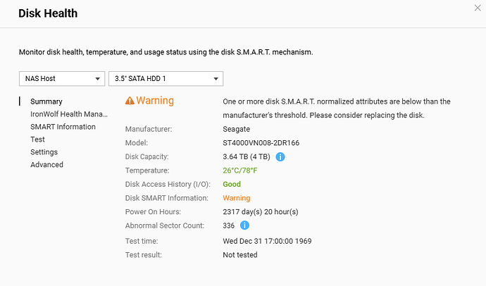

I have a RAID5 array. One drive reports Faulty. A second reports Warning. The drive that says warning shows no errors, it just says “warning”.
I tried to swap the other drive that says “faulty” but the Qnap won’t let me rebuild the Raid array. I think because of the “warning” flag on the second drive.
I’m currently cloning the “warning” drive to a fresh drive with hopes I can put it back in the QNAP…
I may also try to clone the faulty drive. OR simply replace it with a fresh drive and let the RAID try and rebuild?

I only have one failed disk. The system has locked the raid due to a warning on the other disk that reports no errors otherwise. The warning appeared to be due to the disks age, 2800+ days in use. I’m unsure how to remove the “warning” flag on the old disk so I can recover the failed disk, I’m attempting a clone of that disk.

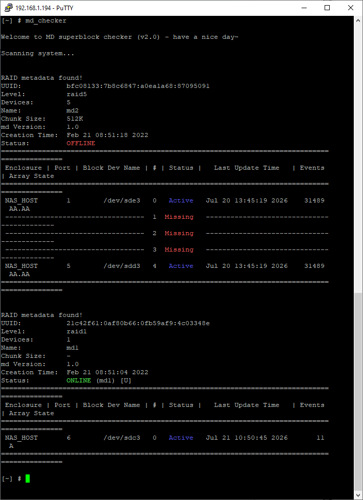

When both cloned drives are in, what does a md_checker say ? If the events have not drifted too far you can try a soft assemble via CLI

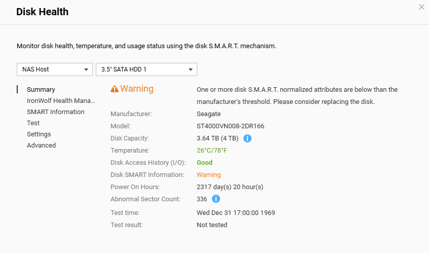

Hey thanks! Yeah I am playing with the Qnap. The warning drive has no errors other than it says operating below threshold. However, this seems to have restricted me from doing a rebuild of the array on the disk that did fail.
I opened a ticket. Also updated specs for my build in this thread.
The screenshots say more than 300 abnormal sectors though, the drive might be working on recovering/reallocating these, but if the drive cannot do that, you have no parity to rebuild the data from.

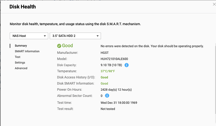

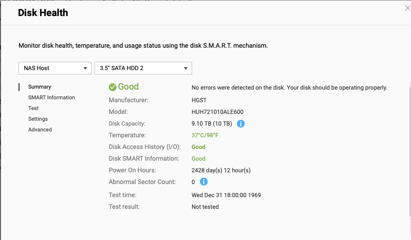

One of my HGST drives has over 2400 days running and it is fine. No errors or anything.
I do want to say that you can adjust the warning notice somewhere in QTS. But I don’t think that is stopping your rebuild. I bet it’s the abnormal sector count as @dolbyman stated.
Thanks for pointing that out. I didn’t realize abnormal represented an error.
How do I know what the status of the QNAP recovering abnormal sectors is?

Here’s the md_checker report
I guess that md1 disk is the cloned disk that is not auto mounted (different disk UUID)

Right now I put back in both issue disks (warning & faulty) for which the report was run on.

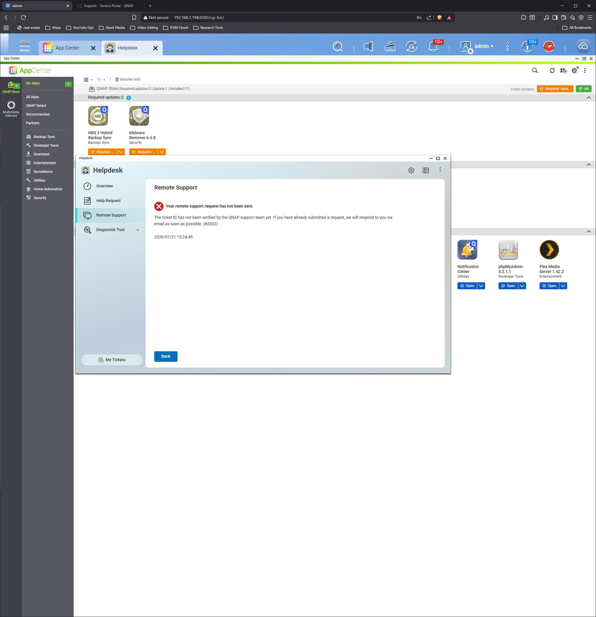

I opened a ticket. They replied with instructions for them to remote connect to the server. I get an error though, which I sent over to them. Haven’t heard back yet. I’ve went through the instructions in their email and checked the ticket number as well as my login multiple times.
