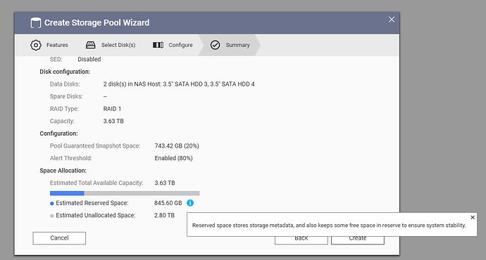

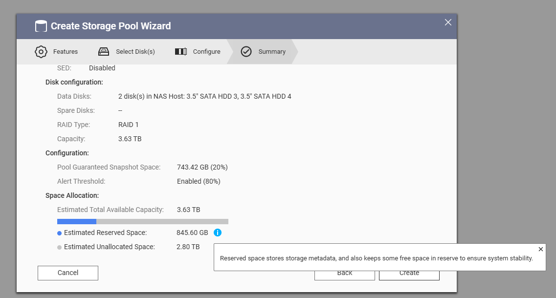

Wow, that’s great, thank you @SteveKo for the clarification.
So I guess, when any of the RAID disks are replaced or upgraded to bigger capacity, the OS components will then normalise or spread across those disks evenly for redundancy.
The reserved space also includes your guaranteed snapshot space you defined
Yes, it does make sense.
thank you @dolbyman .
