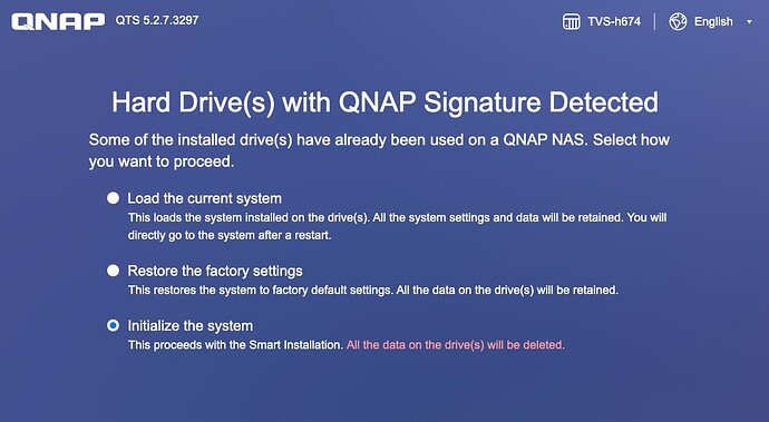

If you do not need all the data on the old hard drive, you can insert all HDD during initialization and then select the last option “Initialize System.” This will delete all data during the initialization process.

Yeah. I did that initially. I think I got a Screen like the one above but I think it only had options to “Load the current system” or “Restore the factory settings” I rebooted the system a few minutes ago, with the disks in, but did not get this option again. Will I need to remove the disks and reboot the system to get the screen you mention above?

That worked! Thanks!! I figured out my problem. When I rebooted and inserted the disks as I had done before, I got the exact same screen I had previously, only showing the two options. I needed to scroll down to see the third option but the UI did not indicate (at least to me) that scrolling was an option. All good now. The NAS is seeing all 4 16TB disks as healthy. I just need to begin setting up PLEX now.
