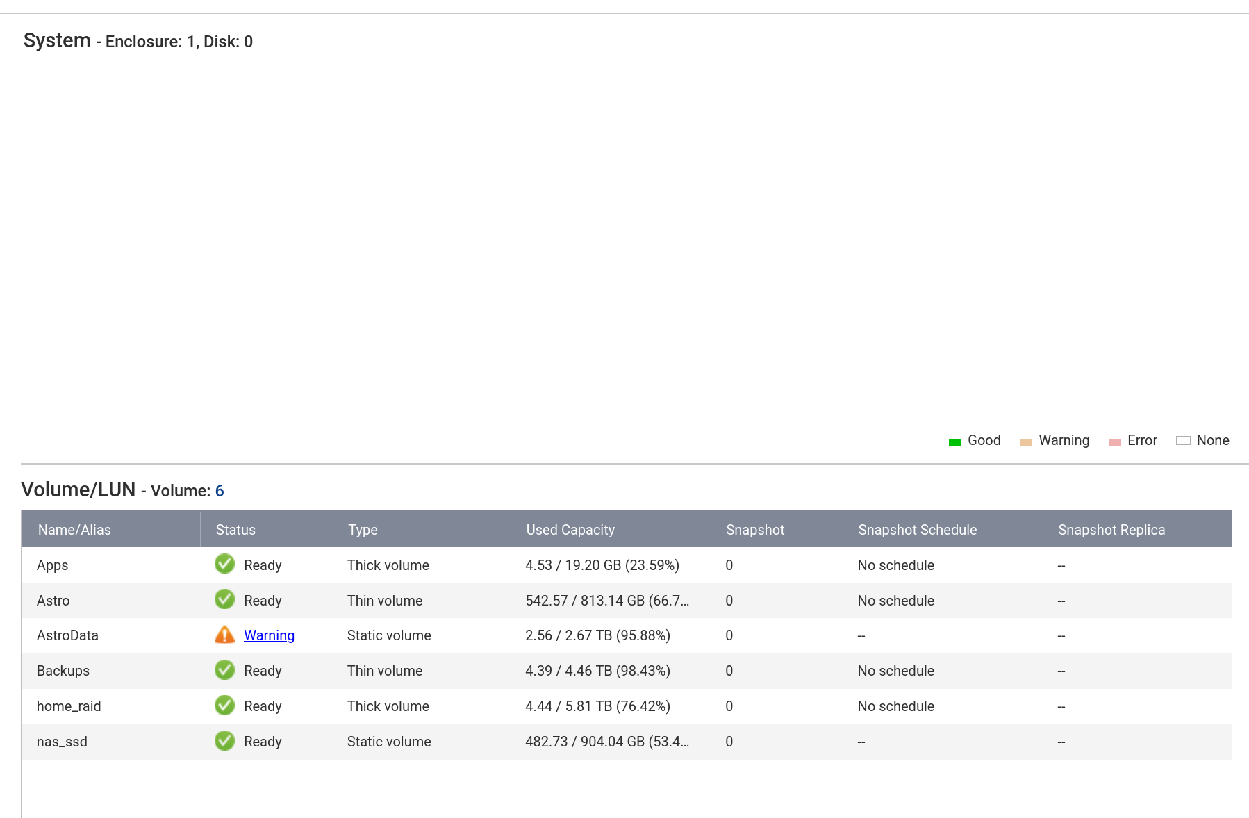

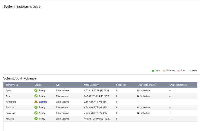

Hello,
I have noticed that most probably after the last update to my TS-531P Storage and Snapshots show 0 drives. I tried to reboot, power down etc. and nothing helps, I see all volumes, the NAS apart from that functions properly, there are no error in the logs.
Any idea what this could be?

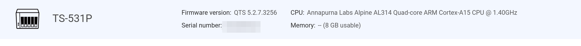

You memory is also not showing right (–/8GB usable)
Tried to reinstall your current firmware, if no newer ine is available?
Yes, I have also noticed that. When I go to Resources Monitor, memory is displayed properly…
