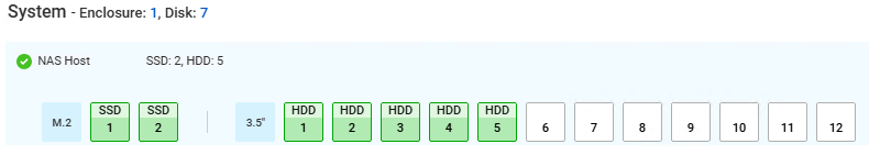

5 HDDs, 2 M.2 SSDs currently configured as a cache.
I’m assuming my best path forward would be to add more drives, create a new pool with the drives, move the data to that pool, and then re-initialize?
In terms of screenshot, does this suffice or do you need more info?
