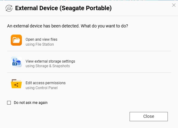

Trying to backup QNAP TS-464 to External Drive
I’m trying to backup QNAP TS-464 to External Drive. When I plug in an external drive I get the screen with “Open and view files”, “View external storage settings”, and “edit access permissions”, but it is missing the “Use this drive for backup” option.

QNAP TS-464-8G-48WD-US 4 Bay High-Performance Desktop NAS with 24TB Storage Capacity, Preconfigured RAID 5 WD Red Plus HDD Bundle
I plugged a Seagate Portable 5TB External Hard Drive HDD into the USB port in the back of the NAS.
Windows 11

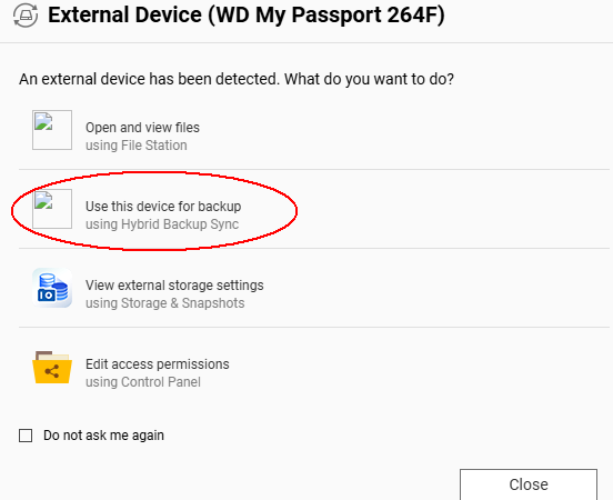

Is there a “use for backup” option?
If the file system can be written to, the QNAP will create a mounted share for each drive partition and that can be used in HBS3

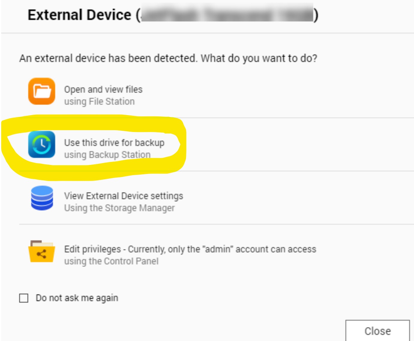

I tried the front USB and got the same response. I’m wanting to be able to back up the NAS to an external drive occasionally or on a weekly basis. I’m looking for the option circled in yellow.
This doesn’t respond directly to your post, I don’t know what triggers that option to appear or not appear, maybe you clicked the “Do not ask me again” option already?
But, can’t you just follow the normal directions (this is what I use) without that popup?
https://www.qnap.com/en/how-to/faq/article/how-to-i-back-up-to-an-external-storage-device-in-hbs
Again though, it may have something to do with the unspecified structure/filesystem on the external drive.
Obsolete. In theory that option shouldn’t be there.
https://www.qnap.com/en-gr/how-to/faq/article/why-backup-station-is-gone
