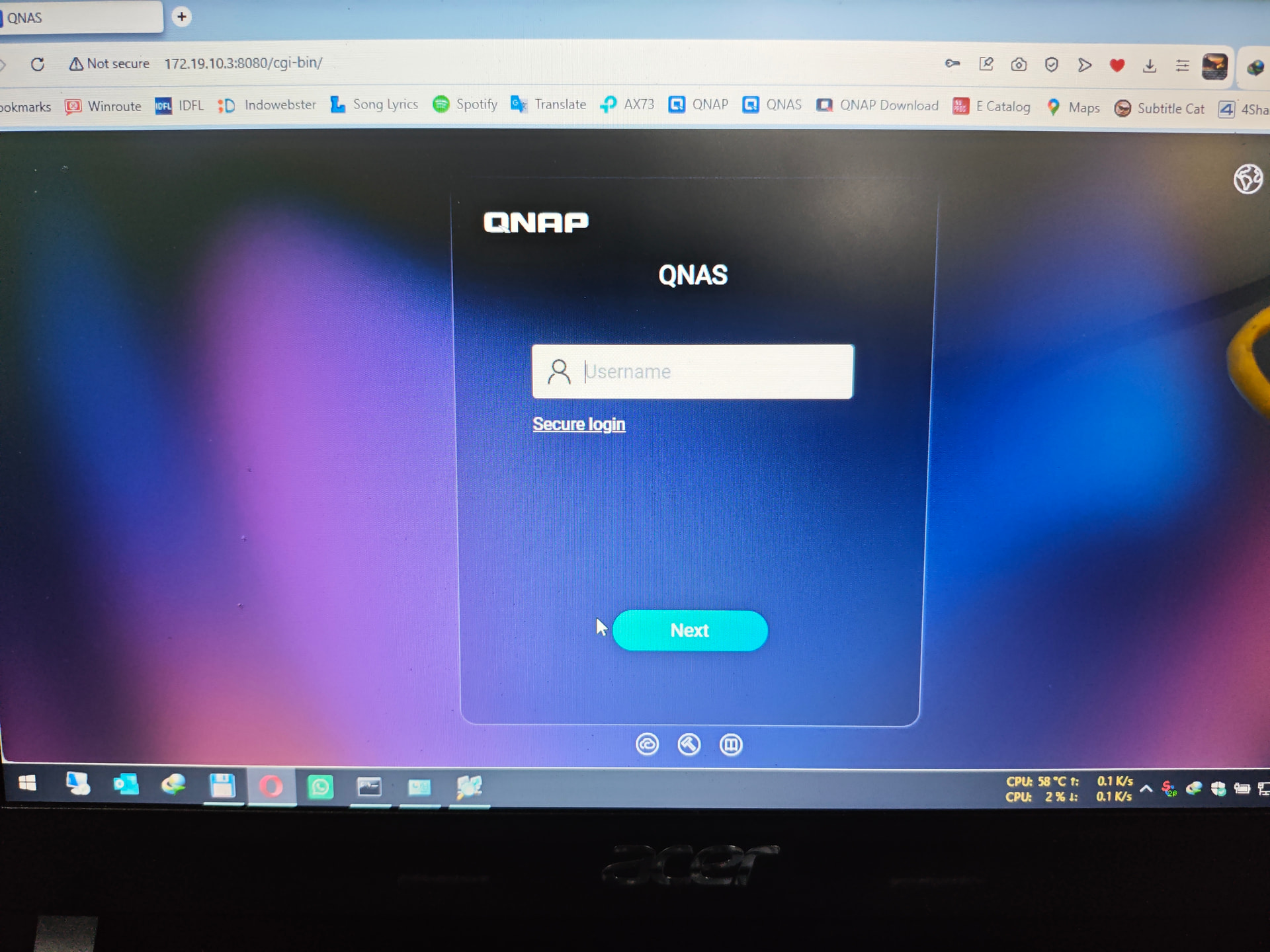

Thanks Man. Try with your advise but not work. I’m despeat … for the last think i’lll do. I took off RAM Module anda CMOS battery … I wash the board with thinner & alcohol & blow up with compressor … of course with pray to GOD… Guest what ?
My NAS is back …

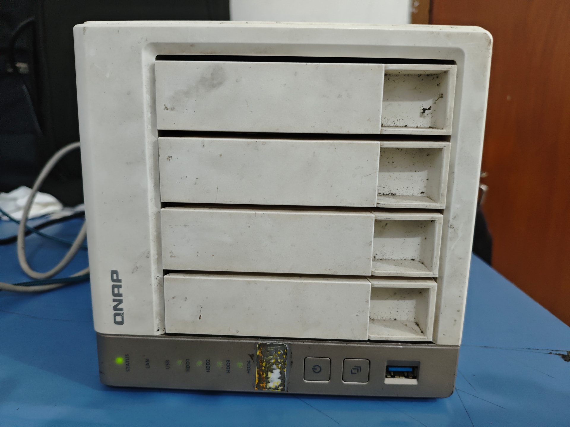

Good for you! Glad you got it working again. But…
Given the look of your NAS, physically, I am surprised it it still running! It looks very dirty. I would clean it up a bit and store it in a little bit cleaner of an environment! As an owner/user of a TS-451, it would by hypocritical to tell you to just upgrade to a new NAS (I did do that and the experience is so much better). But you should consider moving that direction and start saving for a new NAS. Both of our old 451s could die at any time. :smiley:

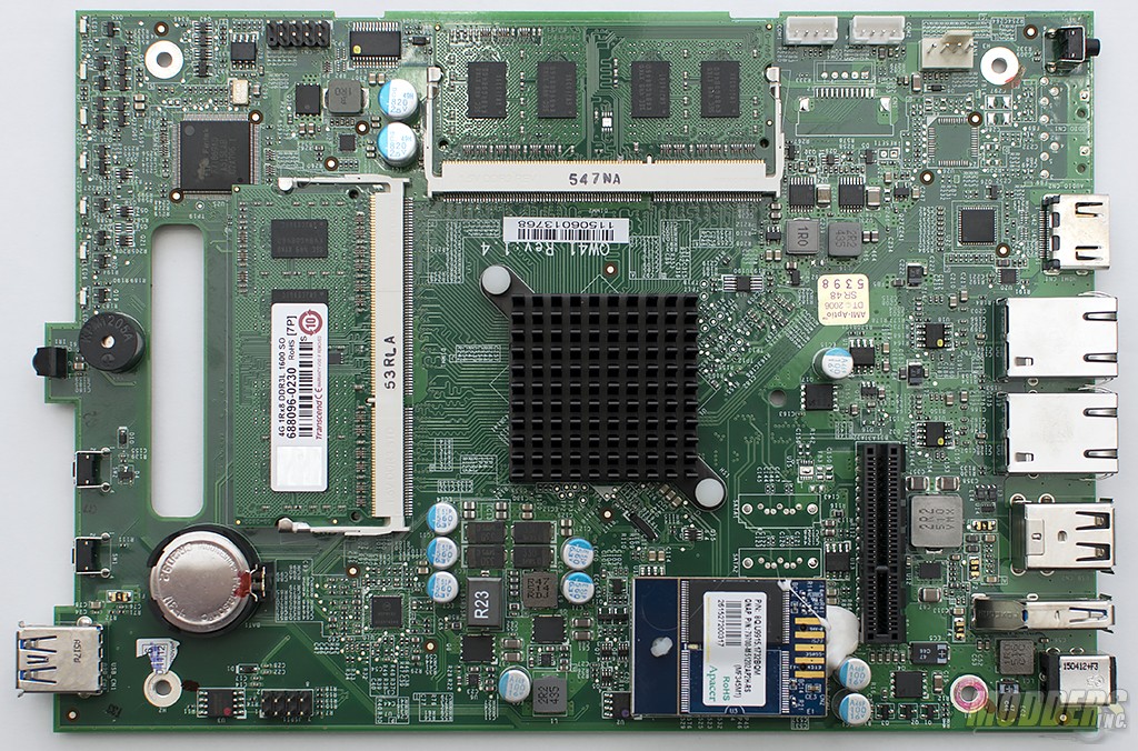

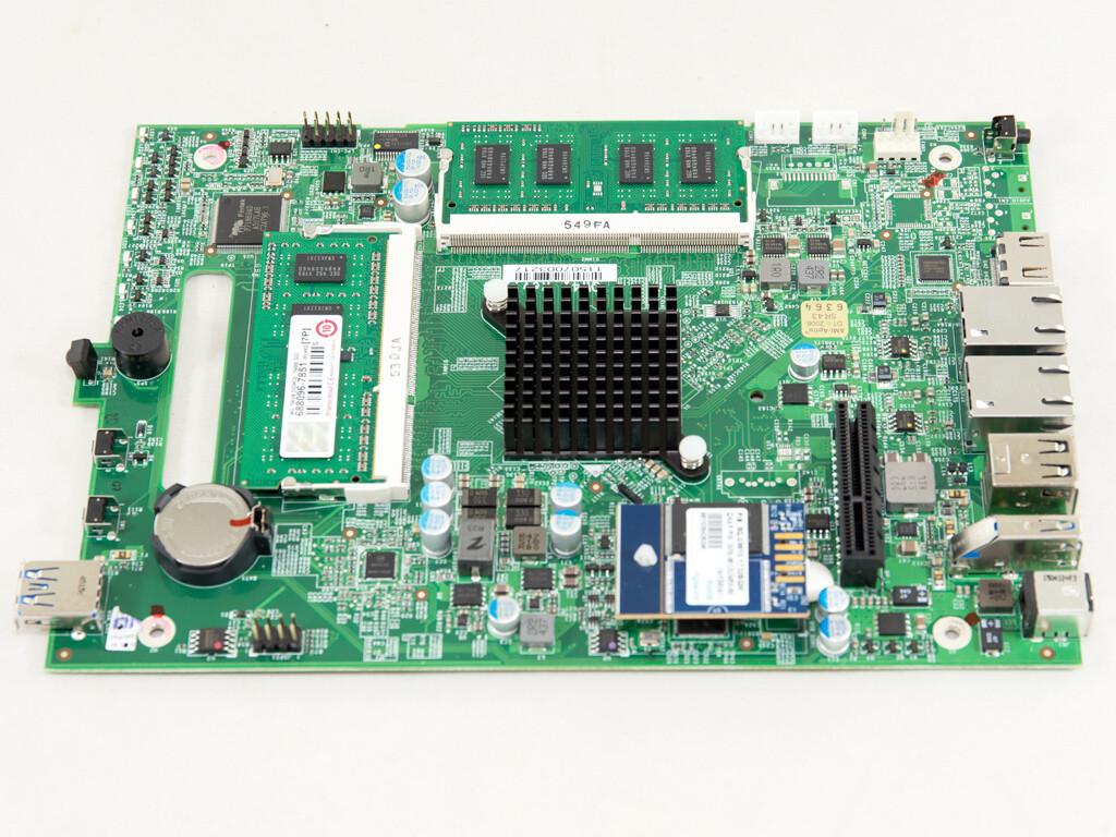

Not sure if both the 4 and 2 bay have the same SATA riser connection, check a couple of pictures out (teardown reviews)
251+
451+
I Try to switch the board… from hardware side.. There is No Issue. All 4 HDD indicator in TS-251+ is Solid green (Not flashing). BUT. There is no activitiy detect.. and its boot loop.
Yes the problem is on SATA riser and those can not be subtitut/vise verse.
