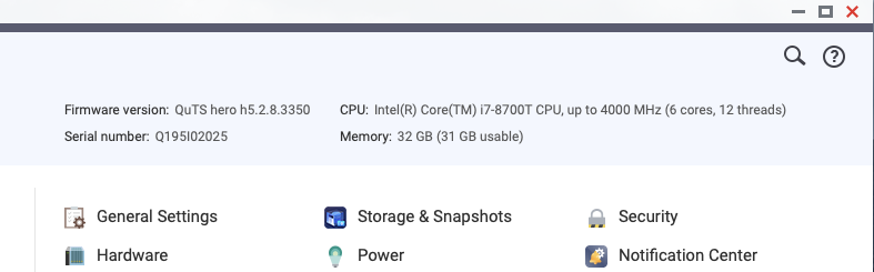

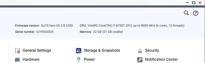

So, after getting the unit back, did I replace the CPU?
Yes. I debated if I should try the i7-9100K or the i7-8700T. I ended up playing it conservative and putting in the i7-8700T this time as the power consumption on the 9100K is quite a bit higher (65 W vs. 35 W). I want to do some more research and see if anyone is using the 9100K in this model. I don’t know if there is sufficient headroom in the power supply, etc. I would think thermally it would be OK. The NAS has a pretty good size heatsink and two fans blowing across it.
So, did the i7-8700T work? Like a charm. Booted right up!
Maybe I’ll hang onto the 9100K and try it when I am in a better position to buy a new NAS if I blow something up! :nerd_face:
