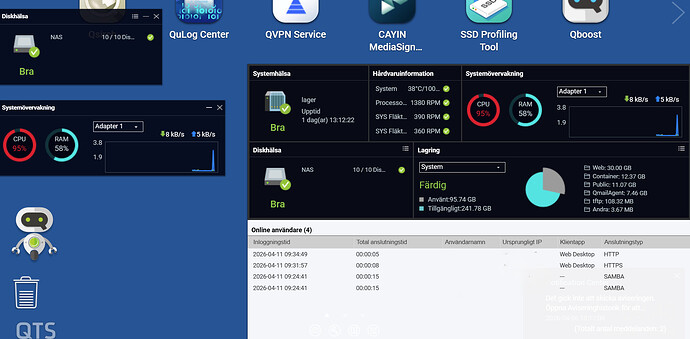

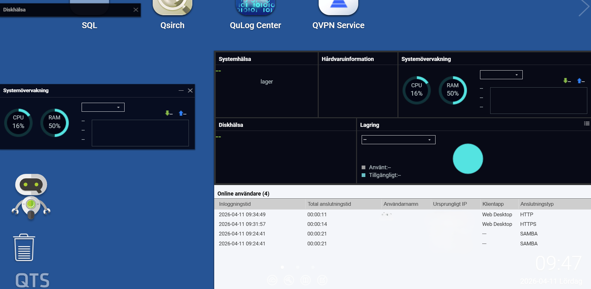

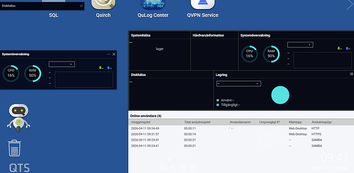

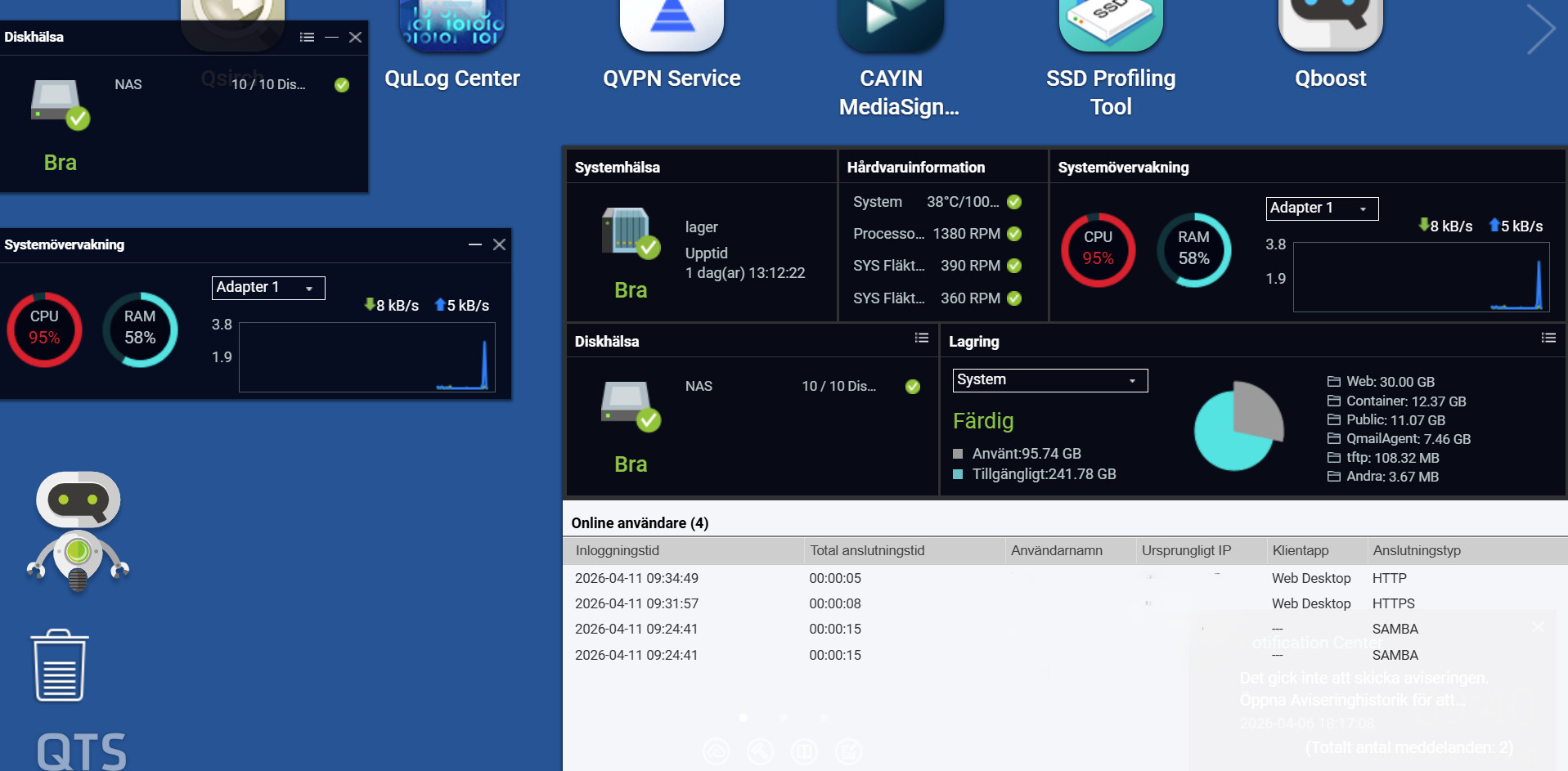

Find 2 views below (also a different UI layout with more apps shown on myCloud login).
I tend to wait for the feedback on the case before changing too much…
The local login:
The myCloud login:
