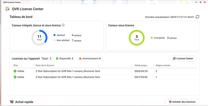

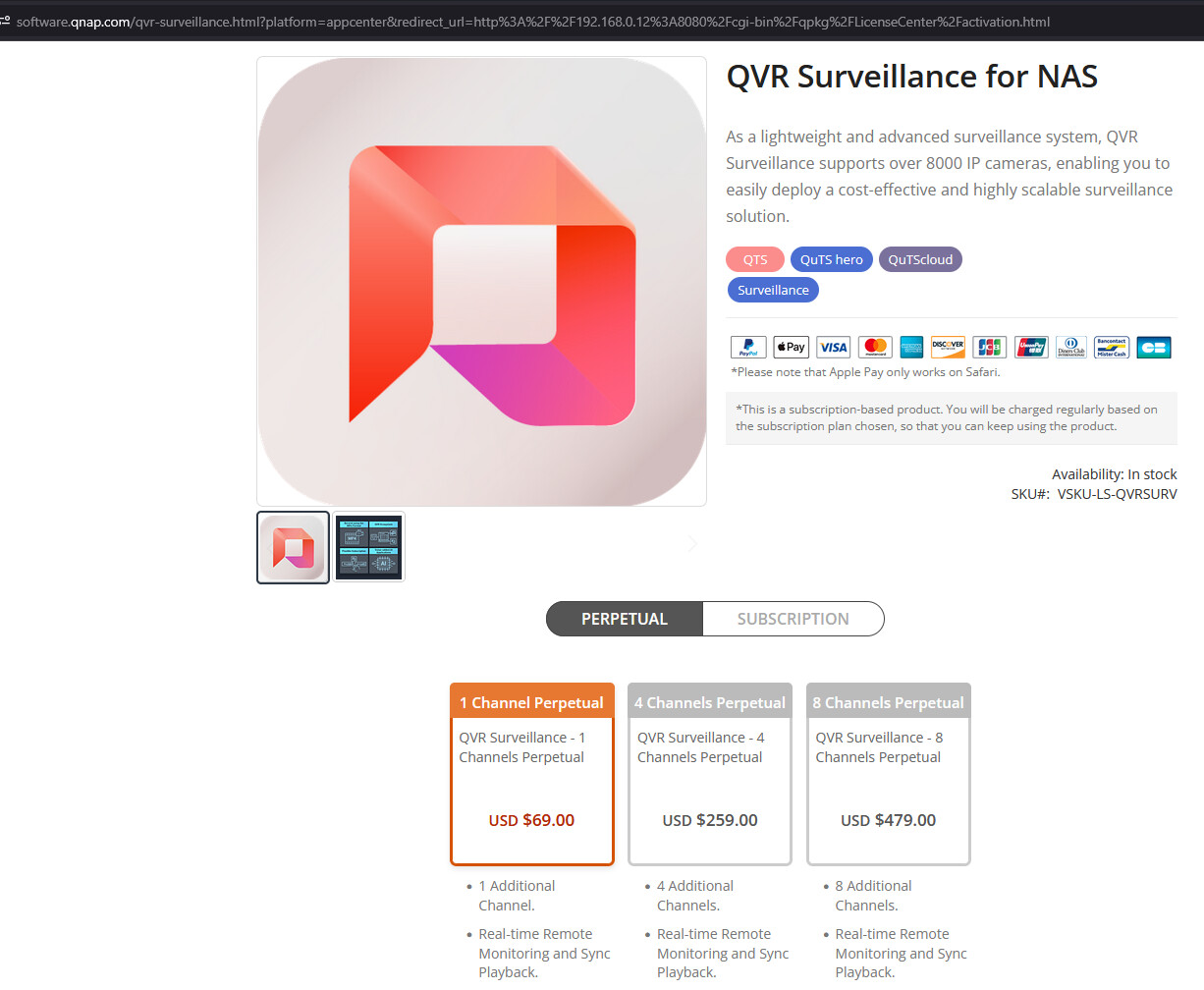

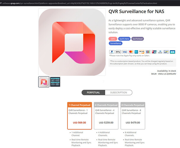

There is nothing free in the store perpetual and subscription….

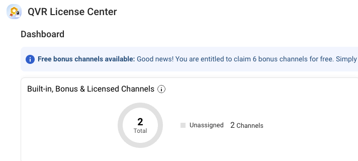

I uninstalled / install back QVR Surveillance and now licence are there.

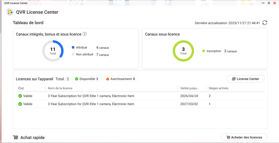

@Alaska99 I installed a new environment, and it should have at least a Build-in 2 channel by default, but your screenshot shows 0…
There seems to be something wrong with your environment. Could you open a Support Ticket let technical team can arrange a remote connection for the RD team to check what happened directly?
After reinstalling, now licenses are there.

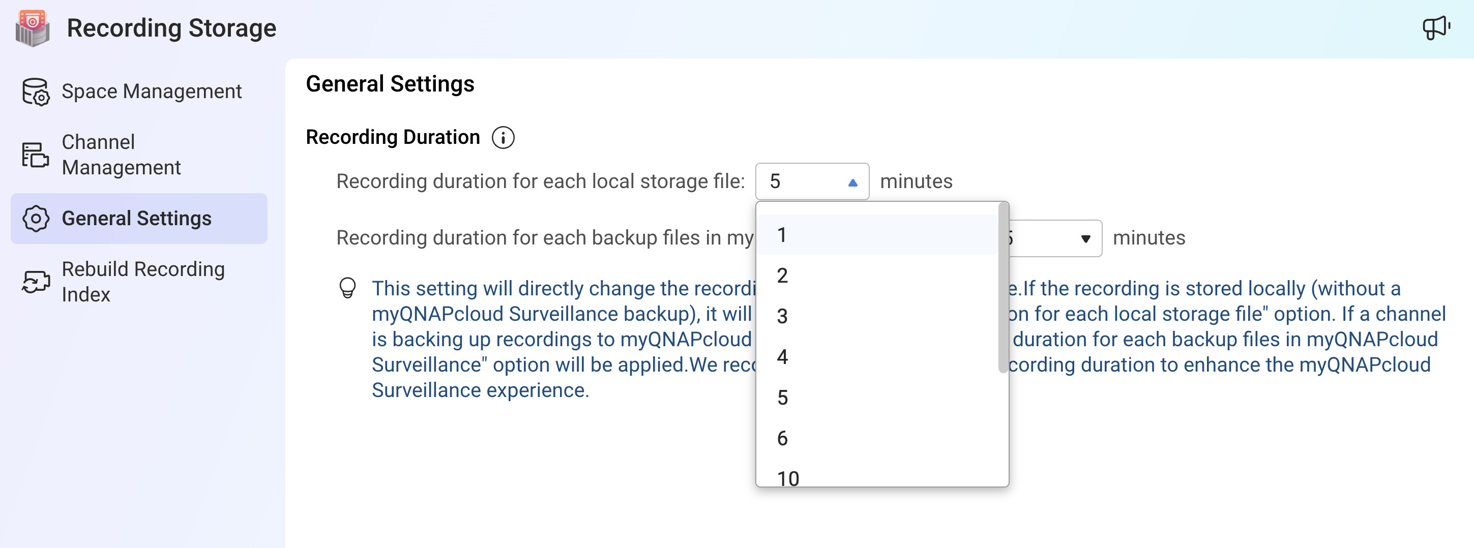

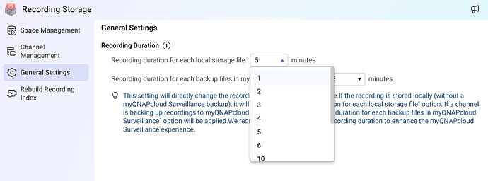

  • Continuous recording is producing 300 smalls videos (250kb each) each hour instead of one big one

@bananas 300 files per hour means one file every 12 seconds, but the minimum option in the settings page is 1 minute.

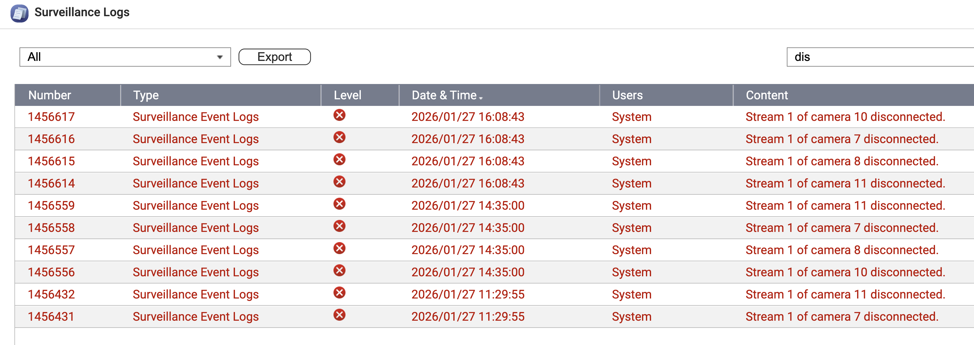

Could you help to check the Surveillance Log to see if there are any stream disconnection records for this camera?
Or you can create a Support Ticket in Customer Service website to liet the Support team can arrange a remote connection for the RD team to check the issue directly.
This bug has been fixed in the next version, sorry for the inconvenience.
Yes, there is several diconection in log. They are visible in the UI too because the preview image sometime fails.
This didn’t happened with Syno :confused:
Curious for the connection status.
Are you currently connect both Syno SS and QVR to the same camera now?
Nope. I migrated a couple of weeks ago, the Syno is off. But the WansView iOS app has no trouble. The disconnections happens even if WansView is not connected.

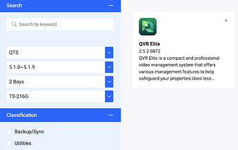

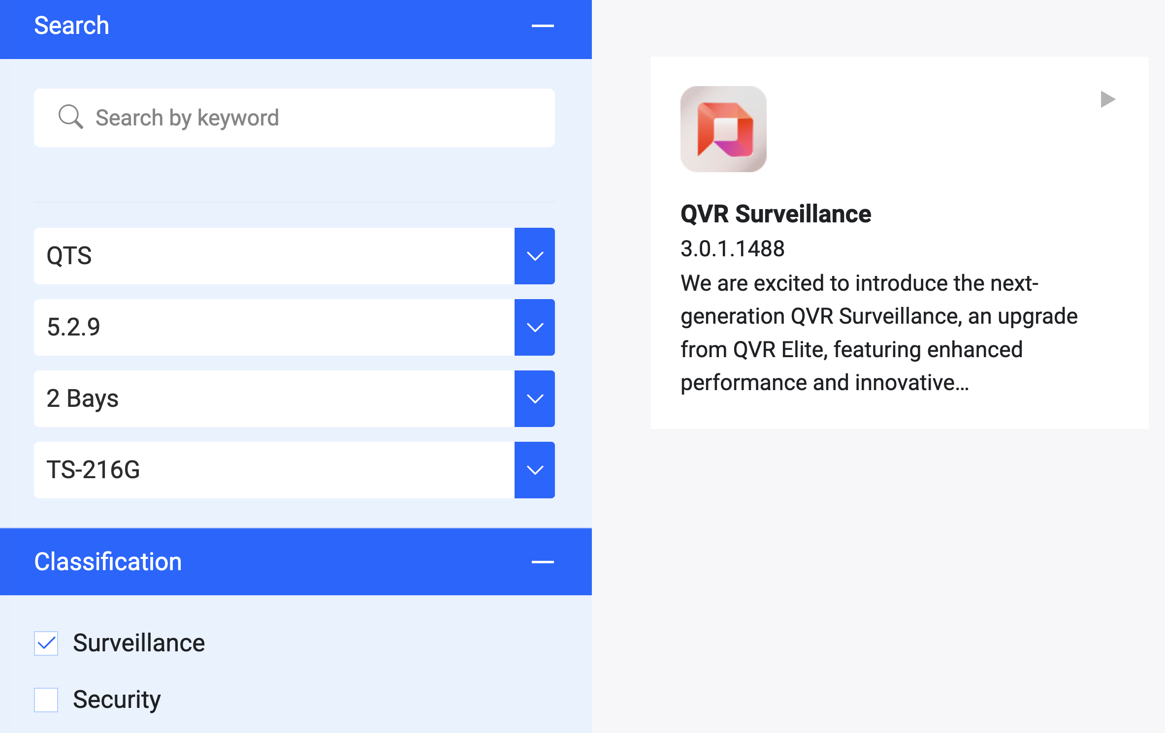

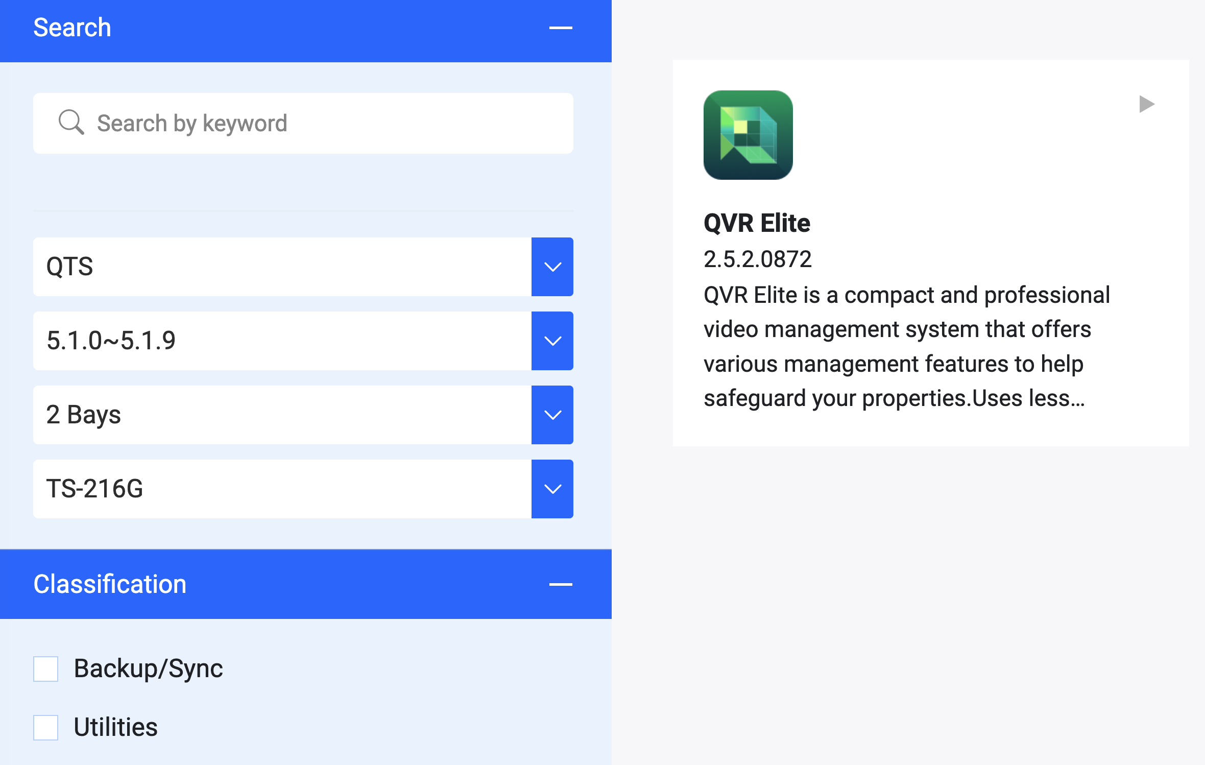

I cannot see the QVR Surveillance 3.0 on my TS216Gs app store. In desperation I installed the Elite in hopes that it will turn into QVR Surveillance 3.0 at one point - but no. Why can I not get the QVR Surveillance 3.0? Is it just because I am noobie on QNAP? My NAS 216G? Or my location Finland? Or something else?
What version of QTS are you running?
Hi @Duugi the TS-216G should can see QVR Surveillance on its App Center
https://www.qnap.com/en-us/app-center?os=qts&version=5.2.9&model=ts-216g&type=Surveillance
Like @NA9D said, could you help to check your QVR version? it required QTS 5.2.0 and later it is normal to only see QVR Elite on QTS 5.1.x.
Thank you both! This solved it 1) i thought that it had updated to latest firmware as I had set autoupdate - but it wasnt and 2) the app was not available on the NAS, but the link you provided worked.

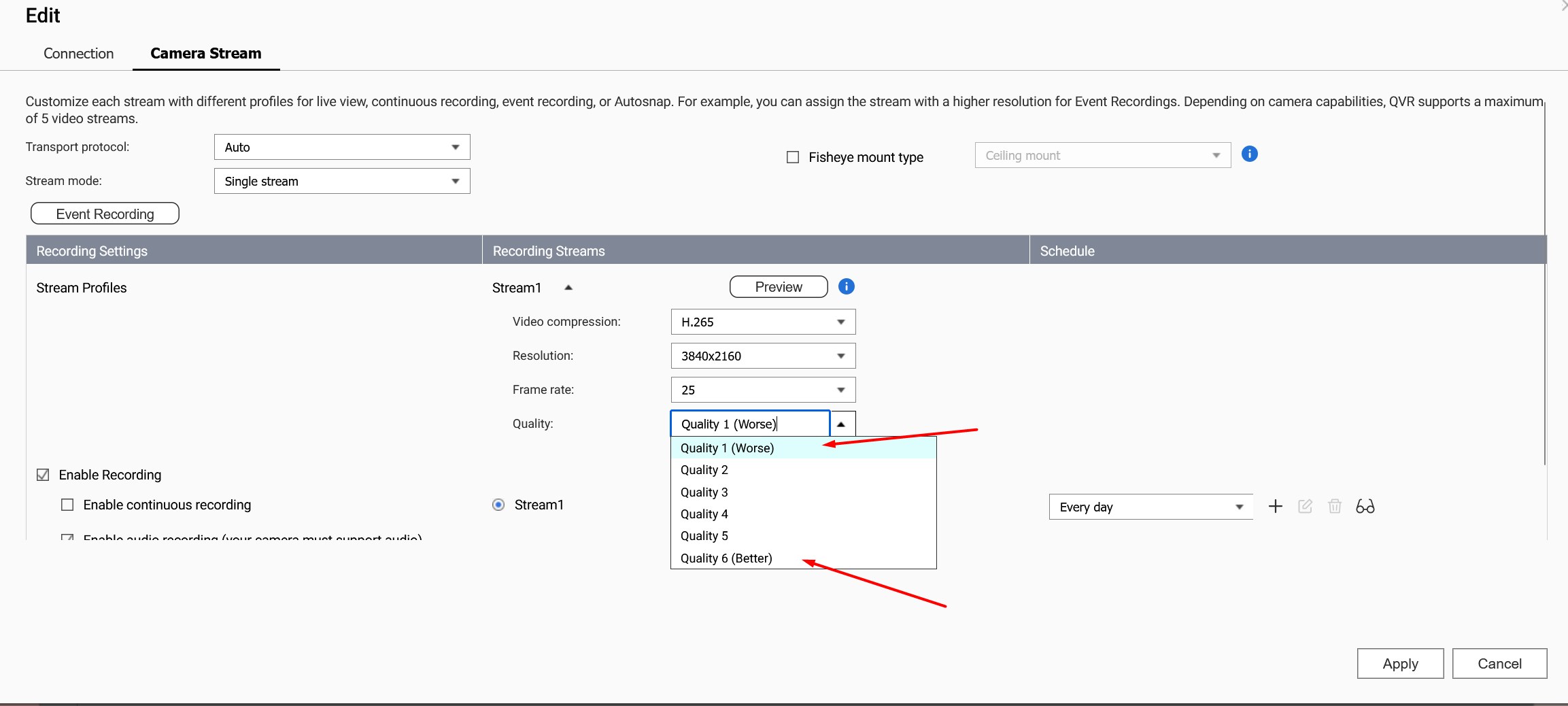

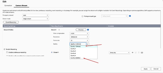

Next thing that I don’t understand is Quality for recordings, I have settings for quality and it has 6 modes but Whatever I set and Apply. Once I go to Edit it’s back to Quality1 (poor) ??? It doesn’t want to STICK to Quality 6(better). Is that a BUG or some weird feature?

As far as the recording controls, I have seen the same thing you have. I’m guessing it’s because you are using ONVIF. If you are actually using a camera driver, then QVR Pro is able to communicate with the camera directly and can do more things such as request a better quality stream, etc. I don’t know if QNAP has direct Reolink drivers, but if they do, I would try using one of those and see if you can set that. Do you really need super high quality recordings for security video? :smiley:

Hi @Lewis for the Quality of camera settings, the team has confirmed that is a bug with Reolink cameras and trying to fix it.
