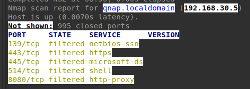

I tried logging into my QNAP (TS-473A running QTS 5.2.3) today and was unable to do so, either through the web interface or ssh.
After several reboots and unsuccessful login attempts I did a “basic system reset” and rebooted again. I then ran nmap to find the new IP of the QNAP and was surprised to find that the fixed IP that I had assigned to it had not changed. (Supposedly, after a basic system reset the IP should be obtained via DHCP.) Furthermore, according to nmap all ports are either closed or filtered. Screenshot below.

QNAP has a security policy will permanently ban an IP that has 6 failed login attempts. So that was why the NAS had all ports closed when I was attempting to access it from my workstation.
