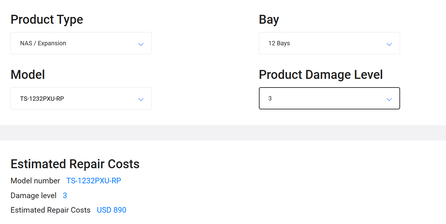

Hello,
i think Level 2 or 3
RMA Service | Quality product repair service | QNAP
Product Support Status | QNAP

Thanks for your input guys.
I have raised a ticket.
It seems the slot is doing something weird - the original disk is back in it, working fine and the RAID rebuilt.
