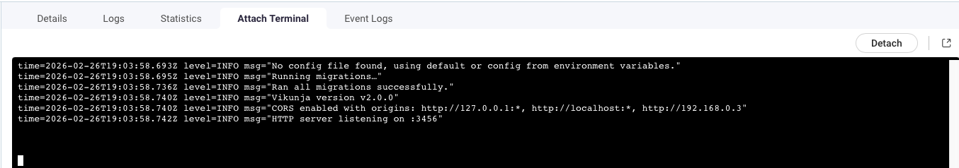

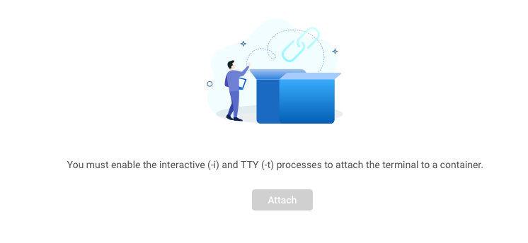

I’m trying to access the shell of a particular container and I get this:

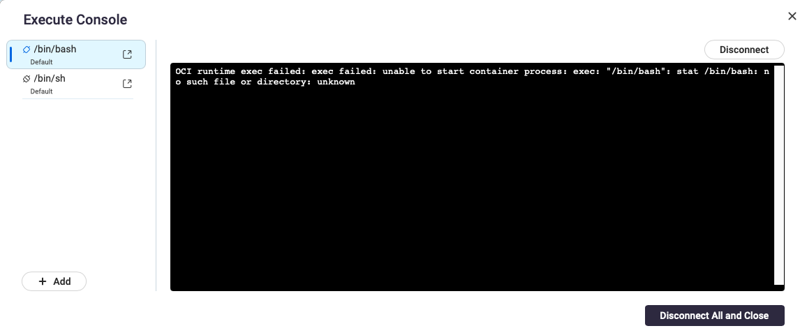

What do I need to do to enable these? I have tty: true in my compose file… It doesn’t help. Other containers I run have the shell attached. This one does not. If I try “execute” - I get this error:
So stuck…

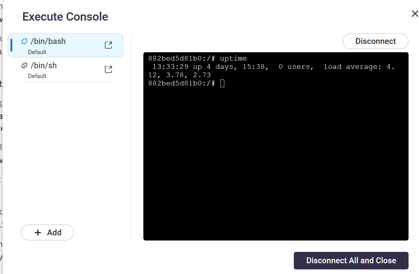

I just tried this on uptime-kuma and it worked fine

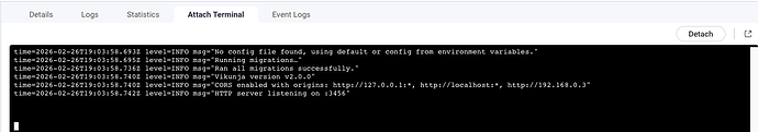

I just tried adding stdin_open: true and I am getting closer:
But still not able to get into the actual shell of the container.

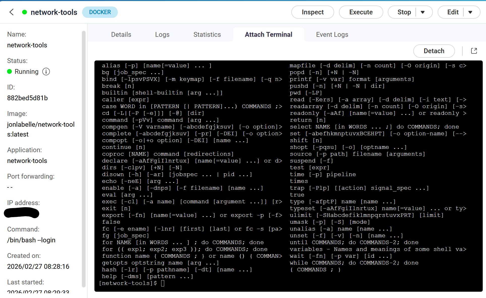

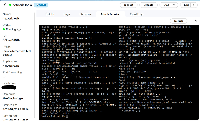

strange, I am able to connect and run commands in a simple networking tool application
services:
  network-tools:
    image: 'jonlabelle/network-tools:latest'
    restart: unless-stopped
    container_name: network-tools
    stdin_open: true
    tty: true
    networks:
      - backendApps
networks:
  backendApps:
    external: true

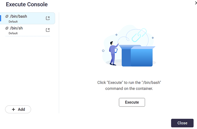

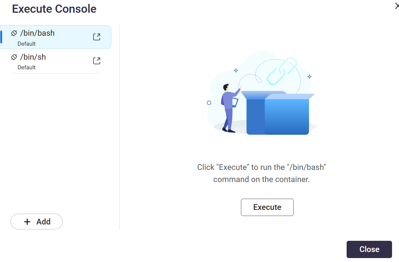

Could be your app doesnt offer a shell to interact with and you need to launch one using the Execute command.
pick which you want (bash/sh) and click on execute, you get a log in shell and you can run commands in it.
See if that helps at all.
When I try the execute console I get the error shown above.
that likely means they did not package a bash command in the docker image. So i don’t think you will be able to connect to it with a shell.
