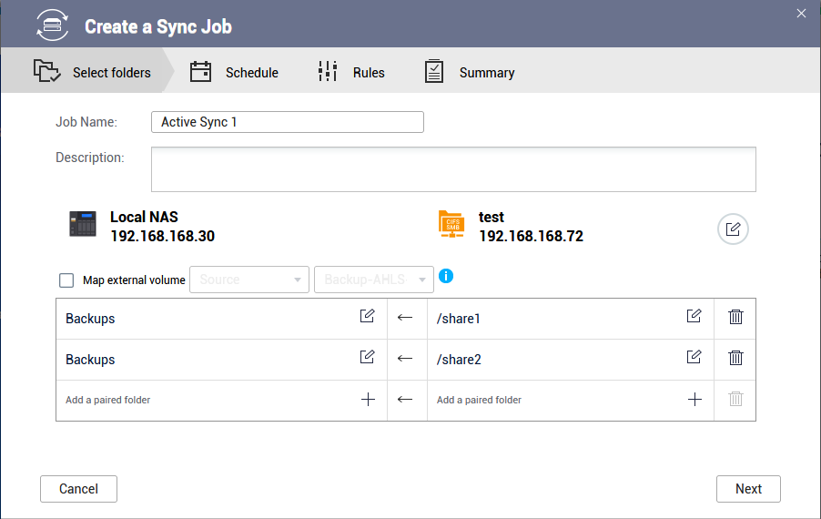

If I do an HBS3 active sync job (pull) I can mount several different shares (or subfolders of shares) into one job.

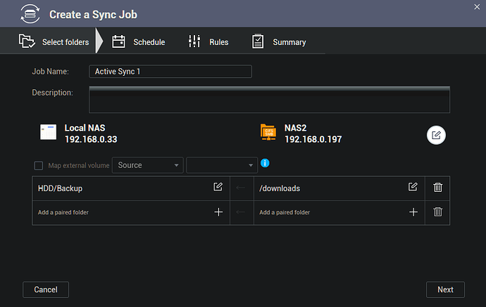

That’s what I would expect. And here is what I have:
:confounded:

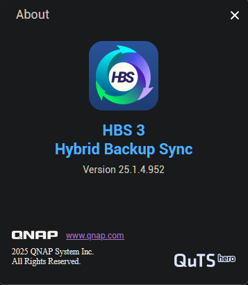

TS-673A, QuTS hero h5.2.3.3006, and HBS 3 Hybrid Backup Sync
Version 25.1.4.952
Works fine on QuTS for me TVS-h1288X on h5.1.7.277 (bit outdated)

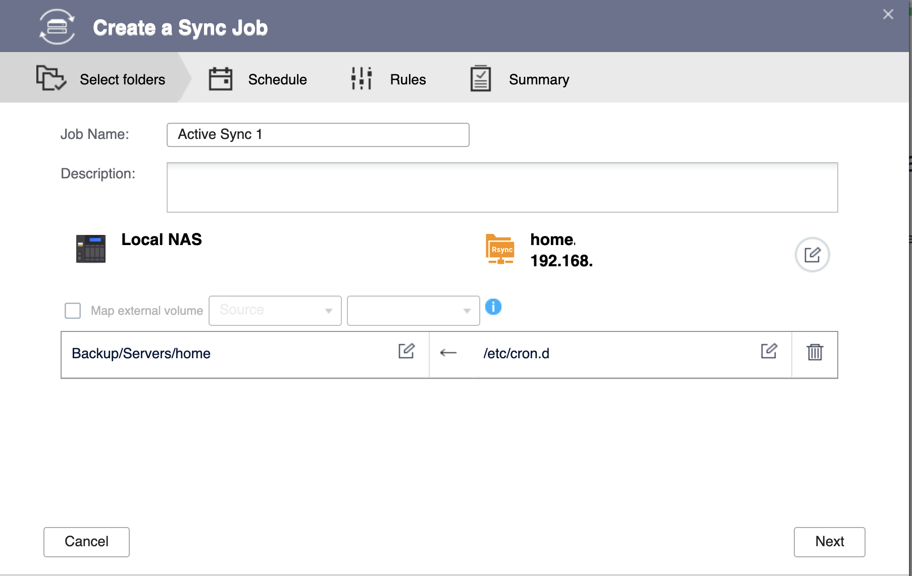

Can you please try the rsync remote server instead of the CIFS? I have no CIFS server, so I cannot do it myself. Not sure if it’s related to the protocol…
I never use rsync, but yes with rsync it does not work to create multiple pairs (just tried)
