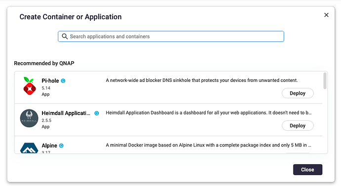

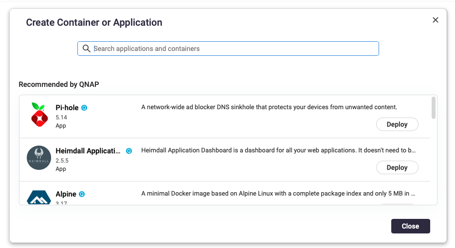

Originally, I set up Pi-Hole in Container Station using the pre-defined app that QNAP lists.
But that doesn’t get the very latest and updating is kind of a pain.

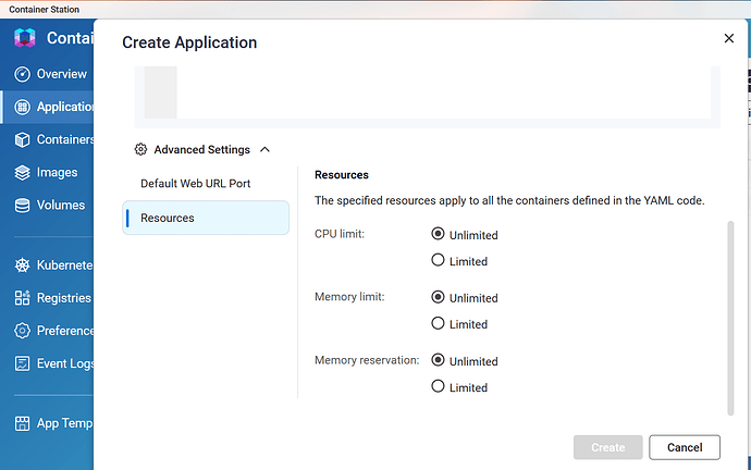

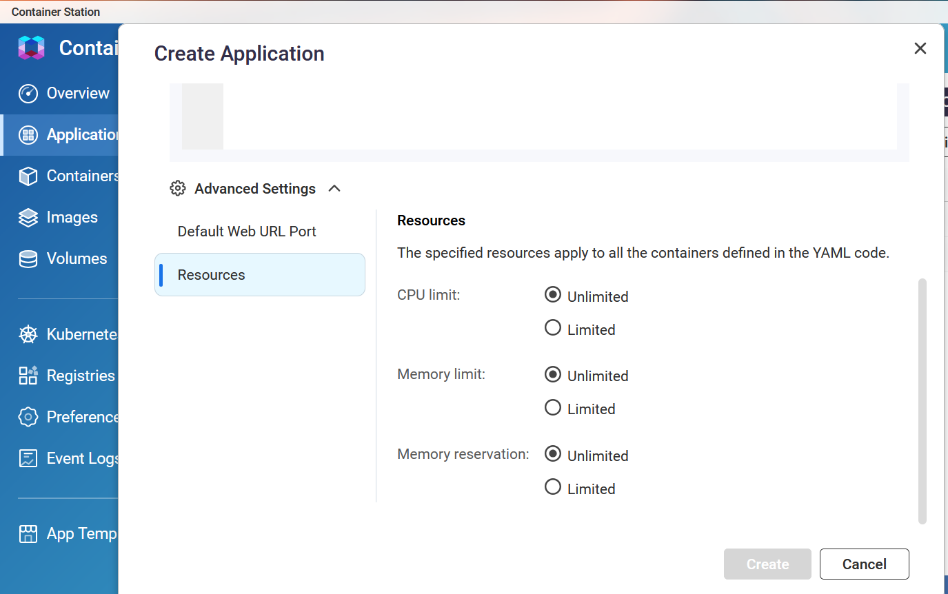

what kind of resources are you giving the container?
it found under advance settings resources when you are creating an app in CS.
Unlimited. Just like you have.
what do the application logs show, any errors?
Also as a test you can try to set the limits to Pi-hole recommended settings. not sure if that will help or not. but I usually dont keep the limits to unlimited just in case the app has issues and takes all the resources of the nas up causing the nas to crash.

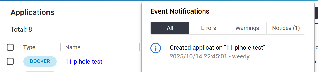

okay i played with it and a few things.
First i converted the file into compose.yaml and used container station application create to deploy it. I set the resource to 2 cpu, 2gb ram.
Also the password field change it name to FTLCONF_webserver_api_password so that is why it wasnt working in your file.
I changed the ports so it wouldnt mess with other apps i have deployed. You may need to adjust networking part to work.
I dont run pihole so i wouldnt be able to add load to see if it fails after a few days.

So thank you @NA9D for making me install the template because now I learned some things about QNAP.
OKAY SO QNAP DEFAULTS

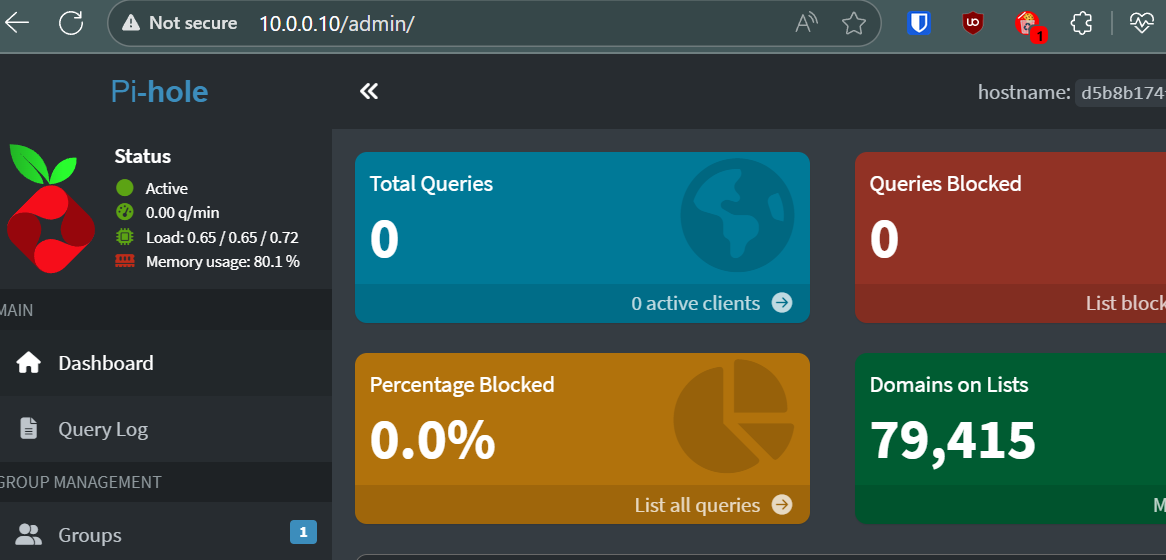

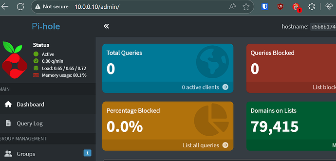

It lives! Good luck with the rest @NA9D
