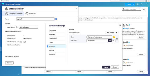

Suppose my container application has a folder /root/apple that needs to be “linked” to a specified directory on my NAS, and I choose to use the folder Container/folder-apple on File Station.
We have two methods. The first is to go to Advanced Settings and Storage when you create Container in GUI, then select Mapping with Host. In the first field, select the folder /Container/folder-apple on the NAS as Host, and manually enter the location of the container, /root/apple, in the second field.

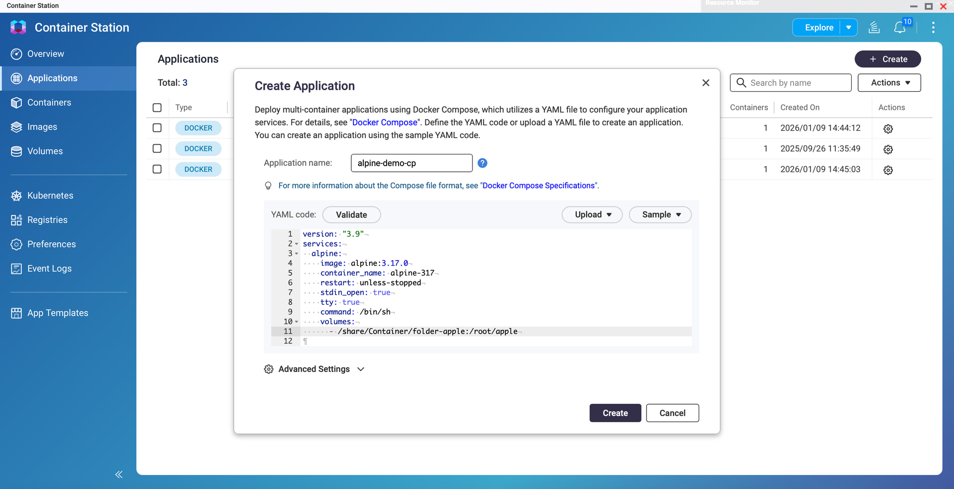

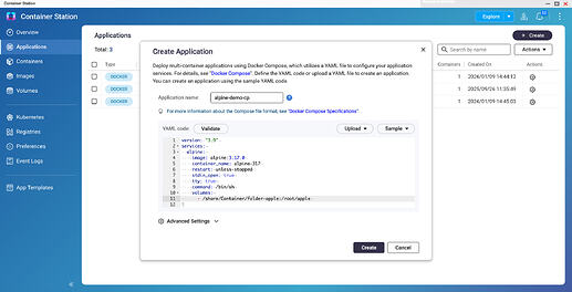

The second method, if you manually create it using a YAML file, is to create a mount point /share/Container/folder-apple:/root/apple in the -volumes field.
The /share at the beginning is fixed, /Container is the shared folder you see in File Station, and /folder-apple is the subfolder. The :/root/apple after the colon represents the location within your container.

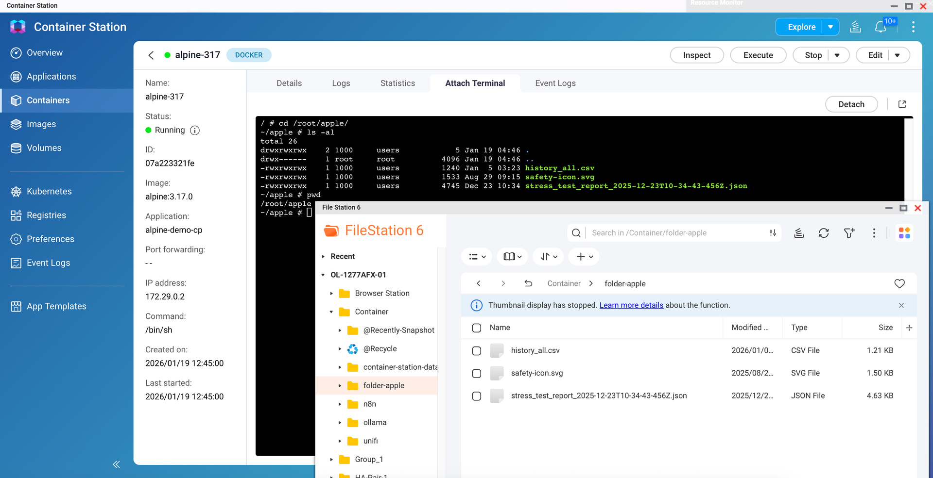

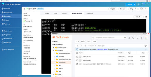

Once completed, your container’s /root/apple will be linked to Container/folder-apple on File Station. Whether the container creates files or you upload files to Container/folder-apple, the files can be viewed on both platforms.
