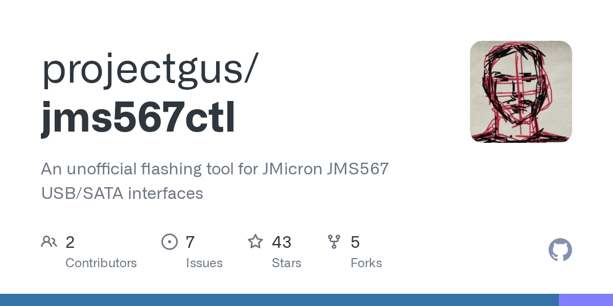

If you can extract the QNAP firmware image from the flash file, you could flash it with something like this
