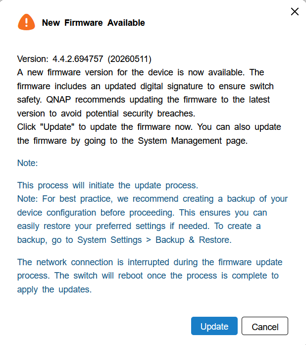

Firmware updated to: 4.4.2.694757 (20260511)

Impact: This is a serious usability and reliability issue. The firmware update notification explicitly recommends creating a backup before updating; but restoring that backup then bricks access to the device. This is contradictory and unacceptable behavior for a managed switch.
