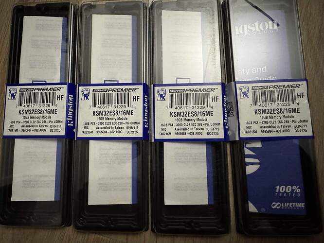

Out of curiosity should you ever have time, mind confirming actual part number of the kingston ram you got for it matches link you shared. I did grab some kingston server ram initially because of what came initially with the unit but diag reported mem cache errors when they were being used.

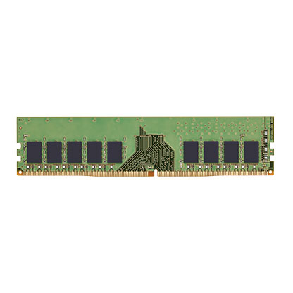

The link I posted has the Kingston part numbers. 1688 4 x 32 gb micron chips (no longer made), 1288 4 x 16 gb hynex chips (KSM32ES8/16HC).
Thanks… I will give it another go then… and see what happens… Looks like Kingston has the Server Premier ram so might try this one out.
