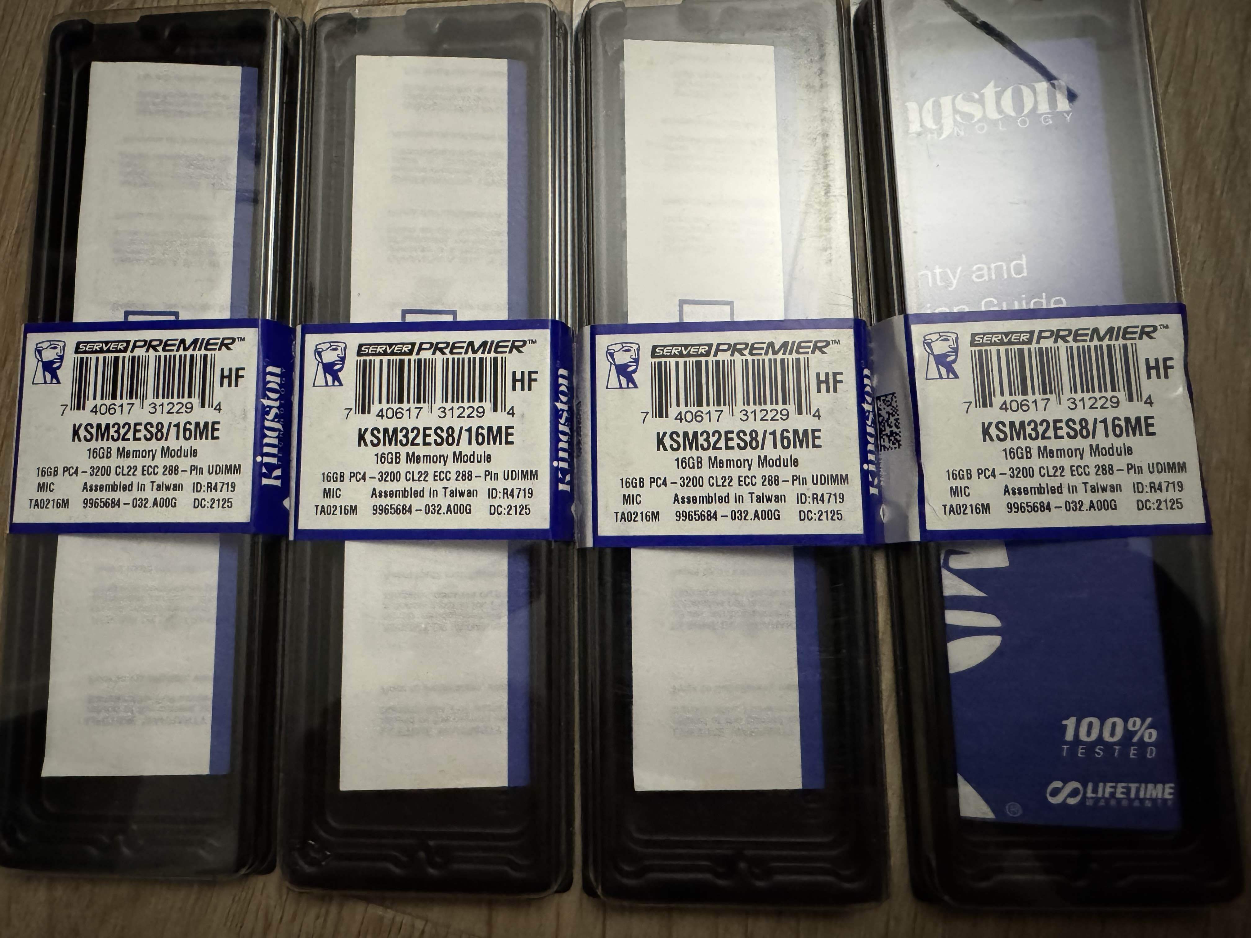

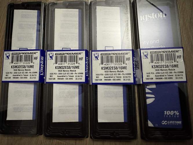

Been using these since Sept 2021. 4 solo sticks. Zero complaints so far.
