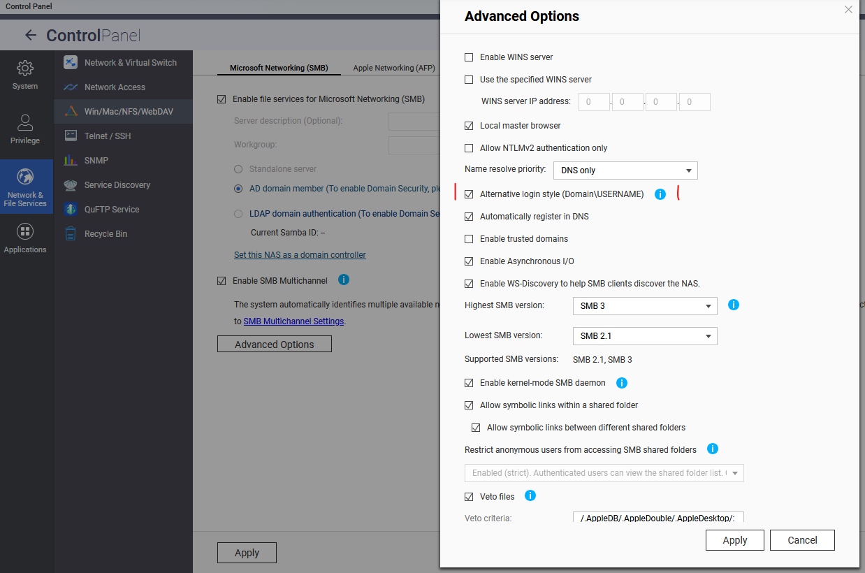

In the advanced SMB options you can set what entry method is used
I set mine to the microsoft default Domain\Username, the default for QNAP is Domain+Username

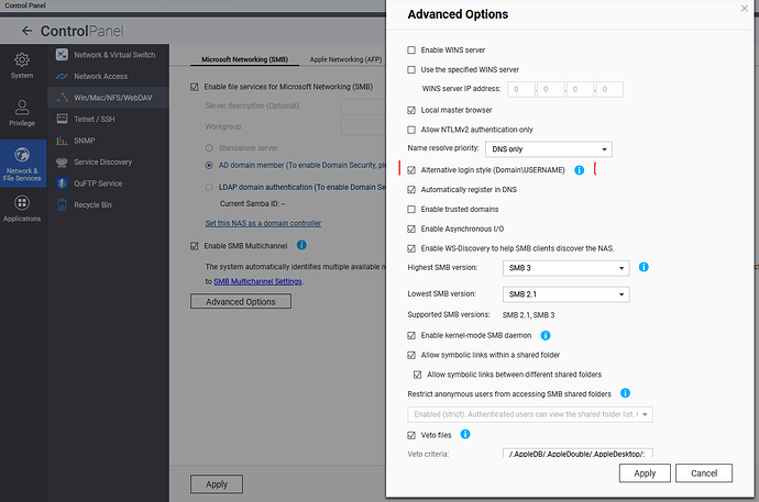

I configured the system as you suggested; however, I noticed that you have it set up as AD Domain Member, whereas I am using LDAP Domain Authentication. I’m not sure if this makes a difference, but I changed the configuration accordingly, and I am still unable to access the shared folders.

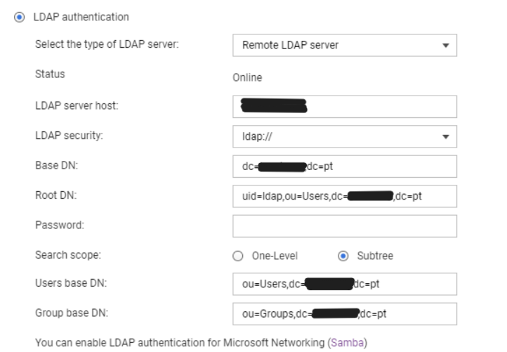

We use LDAP authentication to access our IPBricks servers, which are deployed in each location. Below, I am providing the LDAP settings configured on the QNAP for your review.
Could you help me troubleshoot this issue?

I have never uses LDAP, but these advanced options are missing for you ?
