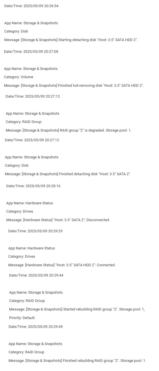

I tested it today with a mechanical disk, and the process worked automatically. You can check the details in the messages from the attached image.
Nope, as soon as you hang more disks in (any any form of usage) they get the OS partitions copied to them … no matter if QTS or QuTS always ext md9 and md13 only difference is SSD vs HDD swap partitions
just login via SSH and do a cat /proc/mdstat and check
The screenshot shows disks removed during operations (rebuild happens)
