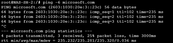

Did you set up IPv6 correctly on the host interface? Recent versions of QTS disables IPv6 by default due to security issue. You need to enable it manually in the “network and virtual switch” and ensure the host has an IPv6 address.
I just created an ubuntu container and it is accessing IPv6 Internet correctly. See screenshot from the container console:
Install iproute2 and run ip a from the container, you’ll see the exact same list of interfaces as the NAS itself if the container is running in host network mode.
