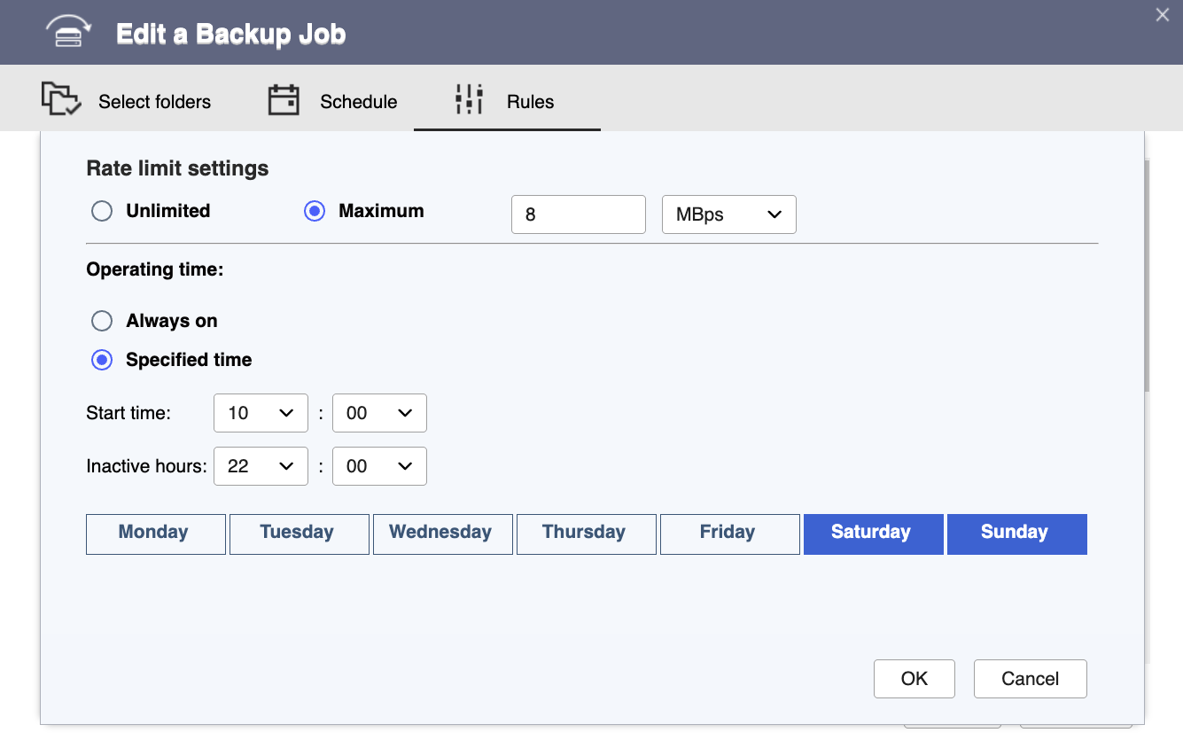

I’m trying to accomplish the following but the wording in the time slots is a bit confusing.
I want to apply limit of 8 MBps only on Saturday Sunday from 10:00 until 22:00.
What i should apply as options ?
thank you /
You select Saturday and Sunday. Set the start time at 10:00. Set Inactive beginning at 22:00.
Hi @great_vc as @NA9D mentioned, by setting the menu like this, you can limit the backup speed to 8 Mbps from 10:00 to 22:00 on Saturday and Sunday.

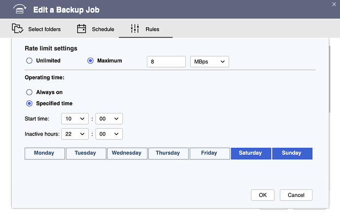

Hello again,
I think this is not working. I have created the job with this settings and my line is peaking up in the upload with 10MBps and i cannot even browse (VDSL Connection)
I see my router starts and see upload in 10 and i have to put there a QoS of 8 to be able to work.
Are we sure about the settings ? Is there anything else that i need to look ?
Hi @great_vc the rate limit should be working as expected. You might need to go to the Customer Service website and open a support ticket to let the HBS team can help to check your environment.
hmm, ok i will create new job and see how it behaves. If i see the same outcome i will go ahead and open a support ticket.
