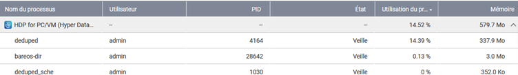

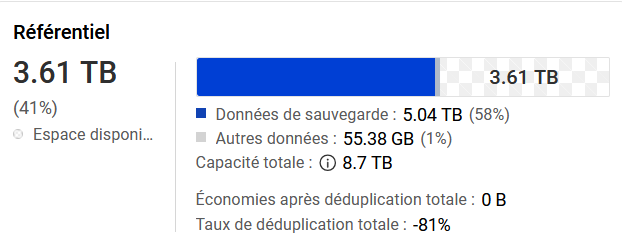

There is a negative deduplication rate!!! (-81%)
And more importantly depuded is constantly running between 5% and 20% and the discs are constantly spinning (and much more than before)

  1. The “0 B saved / negative deduplication rate” on the Overview page is a display issue in the statistics. It appears when a repository is in the Detached state (its original size is counted as 0 while the used space is kept) and stays that way until the repository is mounted again. It can also show temporarily right after a backup job is deleted, or while deduplication is still processing newly backed-up data. It is not related to the encrypted volume.

  • In HDP, open the Repositories page. If any repository shows as Detached, click the ⋮ menu and choose Mount. Your data is kept, and the Overview recovers immediately. (Deleting a detached repository also clears the statistics, but removes its data.)

I just found that yesterday morning de-deduplication process is idle, good news, and also the statistics looks coherent.
