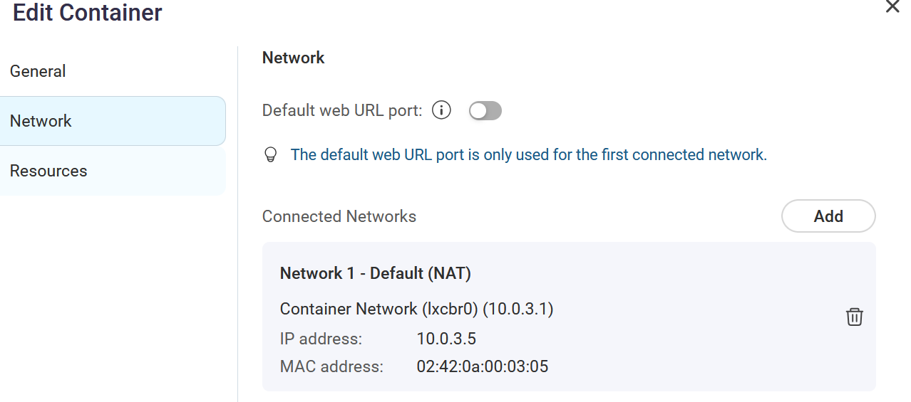

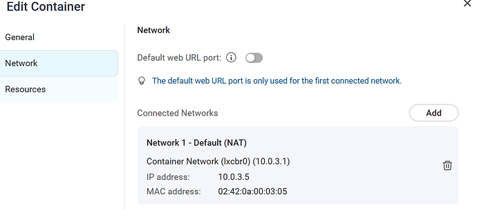

Made some progress with testing out various things
For the NPM app, I have to add NAT and bridge networking. The bridge gets assigned a static IP address. The NAT allows access to other containers.
When testing, I can execute a bash command and use curl within the NPM container to test access. So far, it will not work if I use the main IP address of a container, i.e., 192.x.x.x, but if I use the NAT IP address 10.0.3.x, I can access the other container. The container name doesn’t seem to work within NPM.
I think with enough playing around, I might be able to get it to work. lol
anyone know how to configure the default nat on a yaml compose file? Right now I create the app, then have to edit the container and change networking. I rather define the networking in the yaml file so when i recreate the app/container it already setup like i need it.
