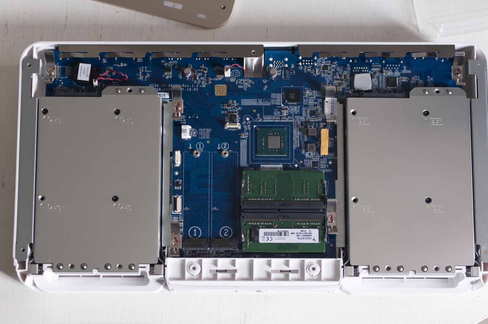

I do not see a USB DOM or header here
check this guide though

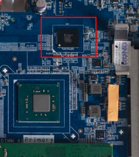

This unit uses an eMMC as a DOM.
However, you can still boot it from a USB stick to rewrite the eMMC.

The DOM eMMC is here:
I’ve tried booting from a Clonezilla USB stick to rewrite the eMMC DOM, but the eMMC does not show up as a device in BIOS or as /dev/mmcblk0 to Clonezilla/Debian, so there’s nothing to write the dom.img to.
This is why I “replaced” the eMMC with an external USB stick. When the NAS boots from the external USB stick I would expect it to acquire an IP address and show up in Qfinder, but it doesn’t, so I can’t update firmware as described in the firmware recovery guide.
