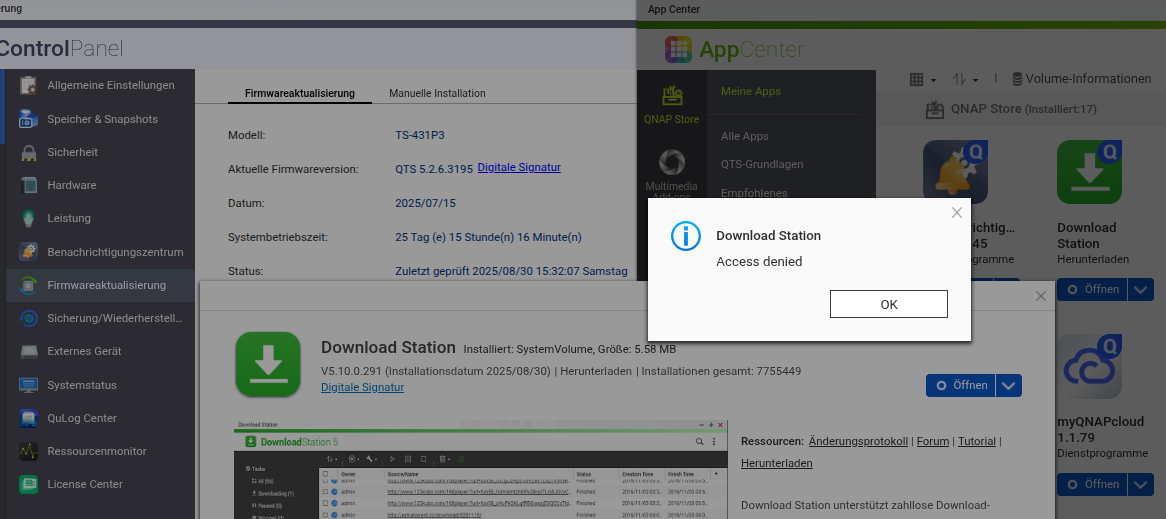

it seems I have the same problem. I can’t start Download Station and get “Access denied”. I have installed it today for the first time. It is installed on the first disk which is a SSD and carries only programs. The data volumes are on
the other disks.
I’ll attach a screen shot that shows the NAS type, QTS version and the Download station software version. I’m running this with a renamed
administrator account.
Any advice how to debug this further?
Screenshot:

now I took some time and tested what you proposed. I enabled the admin account
again and logged me in via the browser interface.
As you assumed I was able to start Download Station then and configure some
Torrents to download them. So this was a temporary workaround for me to get
some files downloaded.
But the QNAP recommendation to disable the admin account and use another
account with administrator rights (i. e. from the administrators group GID=0) for
security reasons is still there.
The normal administration tasks work well with my local lcladmin account. But
being not able to administer the Download Station service with that account makes
Download station unusable for me. I hope that some QNAP staff people will have
a look at this issue and may come up with a solution.

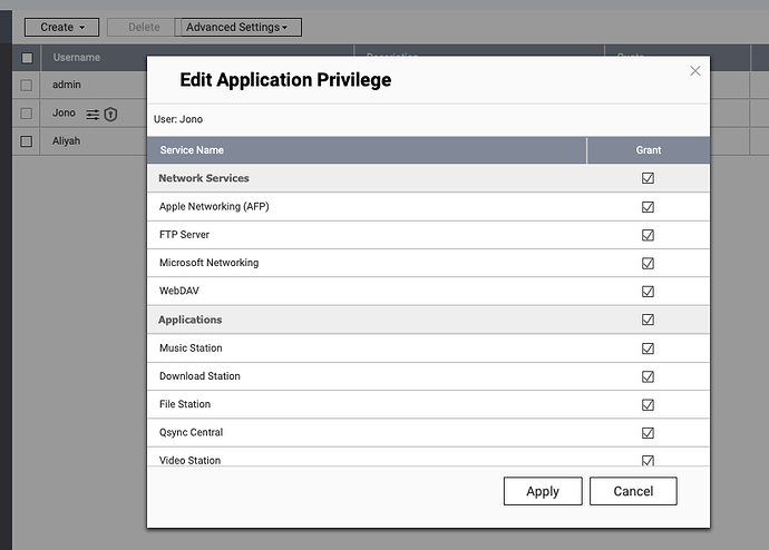

I manage Download Station all the time from a secondary admin user account. It works fine. Check that you have not restricted the rights on download station.

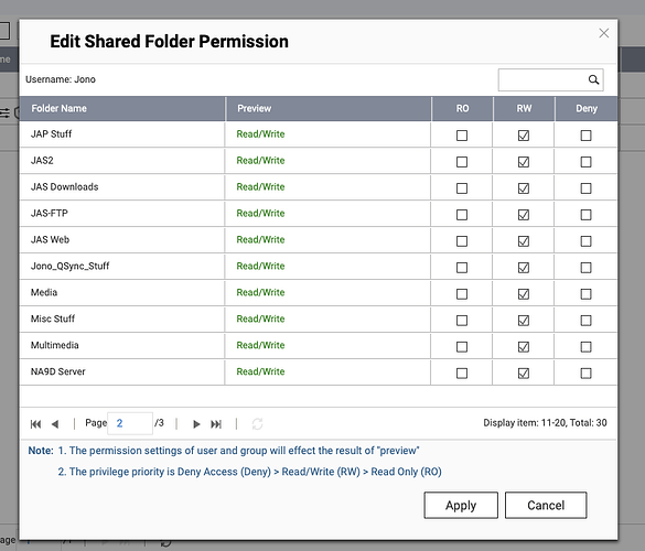

Also make sure you have RW permission on the folder getting the downloads.
Also, is your local admin account part of the “administrators” group or does it have “Delegated” admin rights. If the second, then you have to specific specific things that account can do. But you should always have an account in the administrators group. And check the folder permissions for the administrators group as well.
Also, you can run the admin account no problem w/o fear if your NAS is just on your LAN (which should be the case).
Thanks @NA9D ,
for the record the missing application privilege for the Download Station was
the culprit. After ticking the check box for Download Station in the application
privilege dialog box I was able to start it also from my “lcladmin” account.
