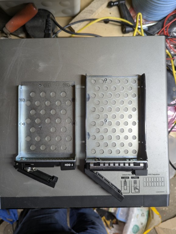

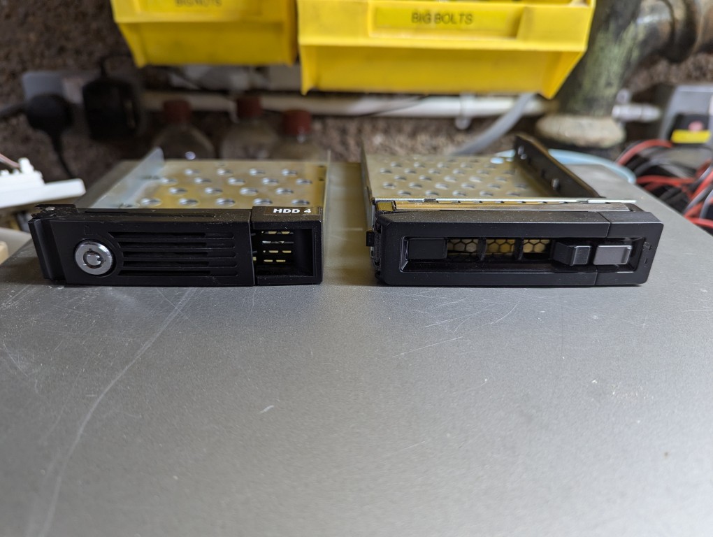

The drive trays for the older style TS-869 and similar are different to the newer style EC880. The older style has a lock and the newer style doesn’t. They are different lengths too. From memory, the newer style trays are longer.
When I get home again I can post pics of the trays side by side.

The older style drive trays are on the left in each case. The newer trays are longer.
Numbers stamped into the trays are;
41325-001554-01-RS for the newer tray
19Z00-000245-04-RS for the older tray.
