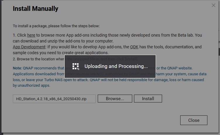

I hadn’t tried installing manually, just the Update in the App Centre
Following your link I downloaded HD_Station_4.2.18_x86_64_20250430.zip and opened the Manual Install dialog.
It seemed to go well, as it recognised it as an application package and started to install.
However, after the “chunter, chunter” from the drives, it sounded 3 beeps, and now we now have
I cleared that screen and repeated the process, this time manually installing Firefox, just to see if I’m doing it right.
It downloaded and installed, in moments, no problem, so there’s something weird with HD Station update, using either process.

Anyway, would you believe, I fired-up the console this evening and HybridDesk Station is now running 4.2.18 and there’s no outstanding updates waiting - so somehow it’s updated.
I can only assume that it was the manual install that worked, despite sitting on that grey Uploading and Processing screen for at least an hour.
