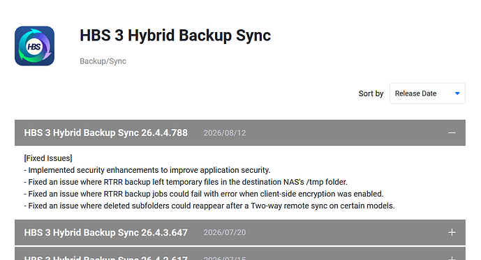

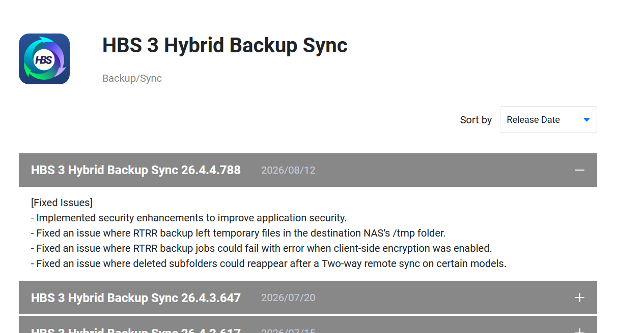

There are no release notes for HBS3 26.4.5.115
https://www.qnap.com/en/app-release-notes?app=HybridBackup&product-line=nas
You can downgrade to HBS3 26.4.4.788

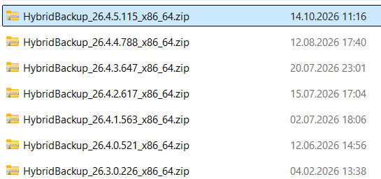

Hi @Becker2020, how or where do you get the previous version for a TS-855X and TS-831X.
Thanks so much
TS-855X Intel-NAS
https://download.qnap.com/QPKG/HybridBackup_26.4.4.788_x86_64.zip
TS-831X ARM-NAS
https://download.qnap.com/QPKG/HybridBackup_26.4.4.788_arm-x41.zip
You must know the version name. I have a lokal archiv
  • HBS 3 Hybrid Backup Sync 26.4.5.115
    2026/10/05
    [Enhancements]
    - Updated Python and related third-party packages to improve stability and security.
    [Fixed Issues]
    - Fixed an issue where folders deleted from the source could fail to be removed from the destination after the next run of a remote two-way sync job.
    - Fixed an issue where folders deleted from the source could intermittently reappear after the next run of a remote two-way sync job on certain NAS models.
Release Notes for Apps | QNAP
