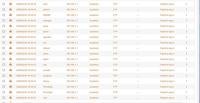

Failed log in attempts over and over via FTP
TS-453 Pro, firmware QTS 5.2.8.3359 Digital Signature
Team, I am getting continued hits from router IP (192.168.1.1) with many different usernames all of which do not exist and admin is disabled. I do run Plex and share with a few friends (3) outside network and restricted to their account info. Attached screenshot but qulog is getting max message so it is continual at this point.
I have QuFTP installed and just de-selected the Enable the FTP server to see if that stops it.
Bots automatically scan every IP address and attempt basic attempts to access your system. This is why you should never directly expose your NAS to such threats. You should disable UPnP on your router and remove any ports that are manually forwarded to your NAS. You should also disable UPnP on your NAS.

You would be shocked if you knew what was being thrown at your NAS right now if you have it published to the internet. You really should not do that. If you want to safely share videos with friends via Plex, then you should all get a Plex Pass or set up a VPN on your router and let them access your server via the VPN.
If it’s your router that sends these out, it’s probably a security suite on your router that tries to identify weak devices on your LAN.
Unless your router has been compromised and malware is now probing your LAN devices, without more info, impossible to say.

The IP address being the local router, doesn’t that suggest that the target is the external published IP address of your ISP connection, and those attacks are being routed by Port Forwarding on your router? You need to switch that OFF.
Both are valid reasons as to why it is happening and both should be investigated and corrected.
But it would show the WAN IP of the probing bot/attacker in the logs, not the router, if it was from port forwarding.

The router is a Netgear RS500. Also it seems that once I disabled QuFTP the issues have stopped.
The symptoms may have “disappeared” i.e. it isn’t being logged any more, but unless you have actually taken the steps to disable the access that was in place, you are still at risk. You need to disable UPnP or remove the manually forwarded ports to properly protect your system and your entire network.
