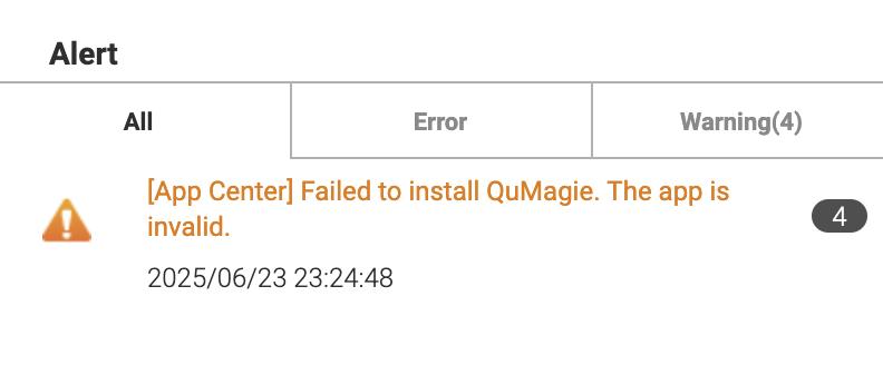

I got an strange notification today which stated “Message: [App Center] Failed to install QuMagie. The app is invalid.” when I didn’t request for QuMagie to be updated.

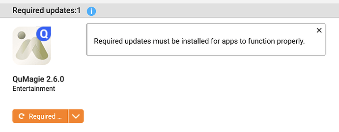

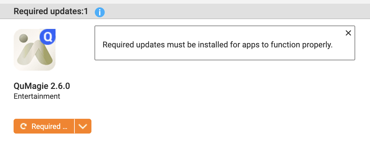

Logging into the QNAP and going into App Centre, QuMagie now says it’s not started as there are “Required Updates”. I am unable to start the app.
Clicking “Update” gives me the same error “The app is invalid.” Is this an issue with a certificate on QNAP’s side (invalid signature on the app package), or something that needs fixing on my side? Is there anything I can do without having to remove and blow away the whole QuMagie library and starting again?
