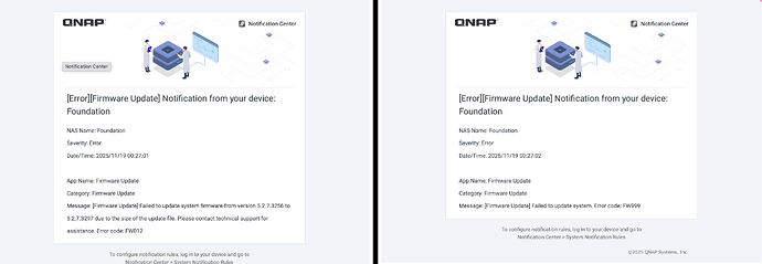

I received update notifications via email during the night:
[Error][Firmware Update] Notification from your device: Foundation
NAS Name: Foundation
Severity: Error
Date/Time: 2025/11/19 00:27:01
App Name: Firmware Update
Category: Firmware Update
Message: [Firmware Update] Failed to update system firmware from version 5.2.7.3256 to 5.2.7.3297 due to the size of the update file. Please contact technical support for assistance. Error code: FW012
Then immediately after:
Severity: Error
Date/Time: 2025/11/19 00:27:02
Message: [Firmware Update] Failed to update system. Error code: FW999
