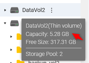

File Station 6 - incorrectly displays the PULi capacity in tooltips; it shows GB instead of TB.
Hi,
File Station 6 - incorrectly displays the POOLs capacity in tooltips; it shows GB instead of TB.
Model: TS-464
Current firmware version: QTS 5.2.10.3577
FileStation 6 v 6.0.5.7994
Best Regard
Thanks for the report! We’ll test this internally to confirm the capacity unit shown in the tooltip.

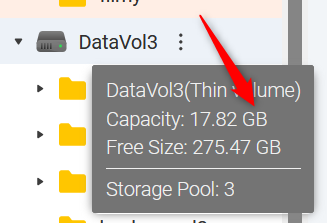

I noticed something else: I freed up some space on that drive, so there was over 1 TB of “free” space, and the correct label reappeared. But on another POOL, it showed the incorrect value again, and I concluded from this that the unit value in the “Capacity” field is always the same as in the “File Size” field, regardless of how much data is actually there and whether the unit needs to be changed to a “higher” one.
